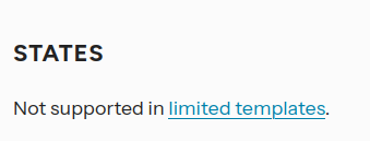

The enabled option can only accept what is known as a “limited template” (only supports a subset of Home Assistant’s template extensions). In addition, a limited template is evaluated just once when the automation is loaded.
From the documentation:
Triggers can also be disabled based on limited templates or blueprint inputs. These are only evaluated once when the automation is loaded.
The template you created uses the states() function which is not supported in a limited template. In addition, your template is evaluated only when your automation is loaded.
