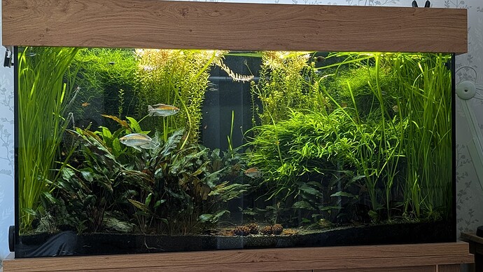

This fish feeding automation’s got 11 triggers and 7 different IDs used in a choose now, for turning pumps, CO2 and heaters on and off. I might have over done it a little :rofl:
In case anyone’s really bored (but I dont recommend it tbh):
