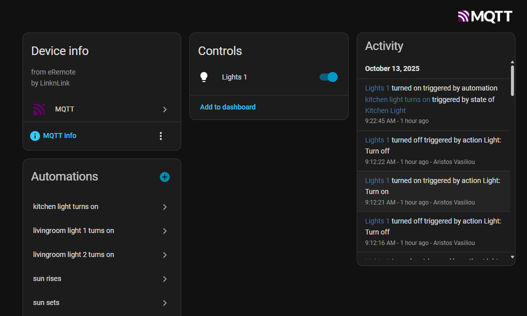

I’m using a linknlink eremote to send commands to a light that came with an infrared remote. the eremote is connected via mqtt to home assistant
What options do you see when you select the device in the MQTT integration
Home Assistant | LinknLink Smart Home?
Go to settings, select Devices and Services, then MQTT and finally the eRemote device. You’ll see the commands available to control the light if they are available.
its just this
