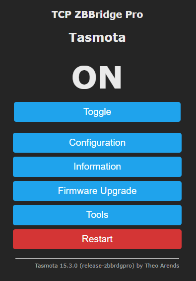

Interestingly, what actually hangs is the Zigbee chip and not the Tasmota firmware running on the ESP32, so I can still remotely connect to the web interface and manually restart it:
As a side note, the “Restart” button only restarts the ESP32 firmware but “by design” it doesn’t reset the Zigbee chip, so a restart that way won’t do anything (unless I physically power it off and on again). However, the reset pin of the Zigbee chip is routed to an I/O pin of the ESP32, so it can be manually triggered to reset - that’s what the “Toggle” button does (why this is not part of the “restart” routine is beyond me, but that’s a separate issue).
