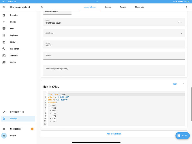

I defined one of the the following condition to close the shutters:
if it is between 3 PM and 8 PM all days (See picture).
But the automation does not work. A test with this condition shows that the current situation does not meet this meet this requirement, but 16.50 is definitely within this slot.
If I adjust to 2 PM it works……But the system uses the correct local time, i.e just saw the log when I did the update to 2022-7.5
Any ideas? Many thanks
I cant see any picture, can you provide pic or even better the yaml ?
Please find it attached
It is weird - I tried it again : the HA clock for this automation is exactly 2 hours behind. But again, I.e. the system update log showed the right time
