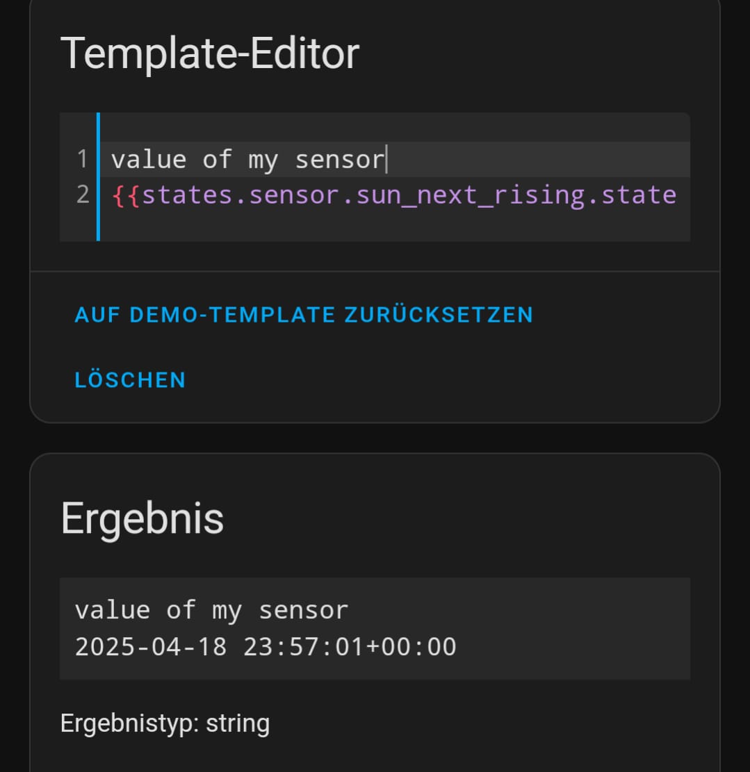

here is what my sensor holds:
Is it an issue that it is of type string (in the template I set it to class timestamp, but I guess that is irrelevant if the value itself is not properly set)?

here we go:
  1. formating the output of my sensor to match what now() has as standard output:
My code for testing
{% set test = states.sensor.sun_next_rising.state | as_datetime +  timedelta(minutes=-210) - timedelta(minutes=float(states.sensor.haus_verfugbare_auto_lade_dauer.state)) %}
value of my sensor
{{ test.strftime('%Y-%m-%d %H:%M:%S.%f+02:00') }}
value of now()
{{now() }}
Results match pretty good:

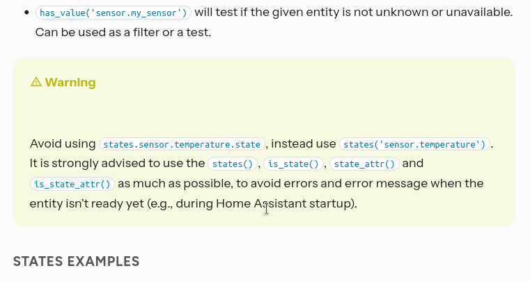

As noted in the “States” section of the Templating docs LiQuid_cOOled linked to earlier, you should avoid using the state-object method shown above, unless it is necessary.
A better option would be:

I’m still a bit buffled. Both of you point me to a page where I don’t find the hints you want me to see.
Could you tell me why the state-object method (that I am using) should be avoided?

ChatGPT tells me: the second option is better as it never throws an error, e.g. in cases the sensor doesn’t exist.
Is this the difference you are referring to?
It’s in the section “States” in a box marked “Warning”…
In some cases these errors can cause entities to get stuck in unknown or unavailable state after restart. That means they can cause knock-on issues in both the frontend as well as in your scripts and automations if they are used there.
