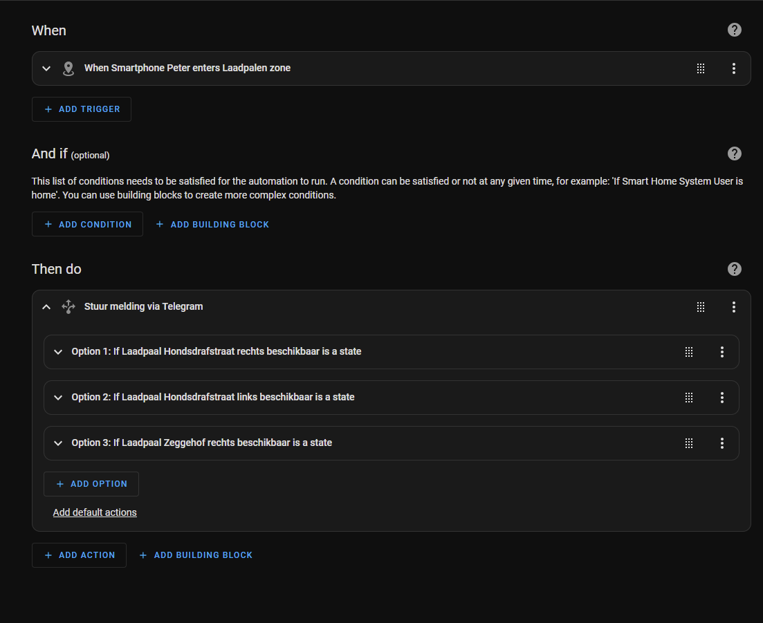

Hi Didgeridrew,
Thanks for your reply.
I changed the automation. I think it should work.
When my phone enters a zone round my house, and if at least one charger is available, I receive the corresponding message. Like in the picture.
I will test it tomorrow.
