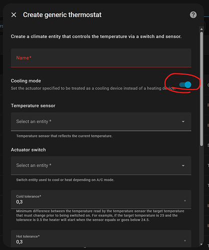

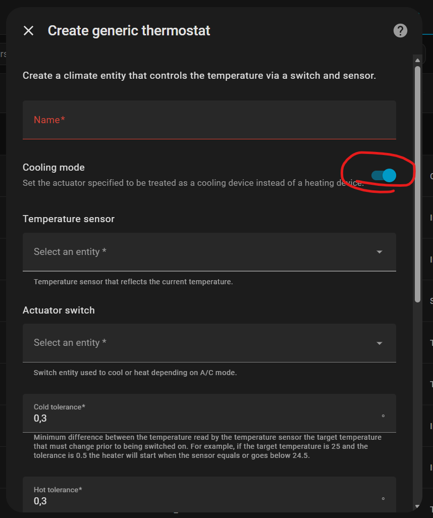

I would suggest the generic thermostat in cooling mode.
settings → devices & services → helpers
The generic thermostat did the trick. But my original automation looks like this :
