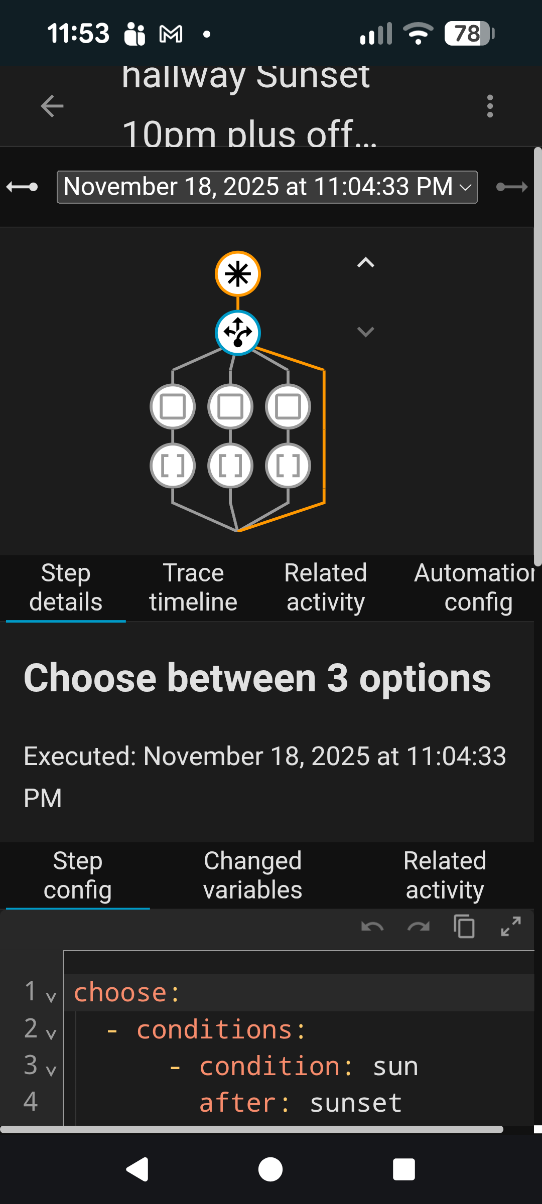

What does the trace say?
Try using state as the trigger. Read this
Thanks. I’ll check that out.
I am not sure this will reveal the problem.
It tells that it at least triggered and the time it triggered.
Also that none of the choices were valid condition wise so it stopped.
From there we need to look at the conditions and why they were false.

But you will need to post a trace when it should work. Not a trace from when it should not work.
