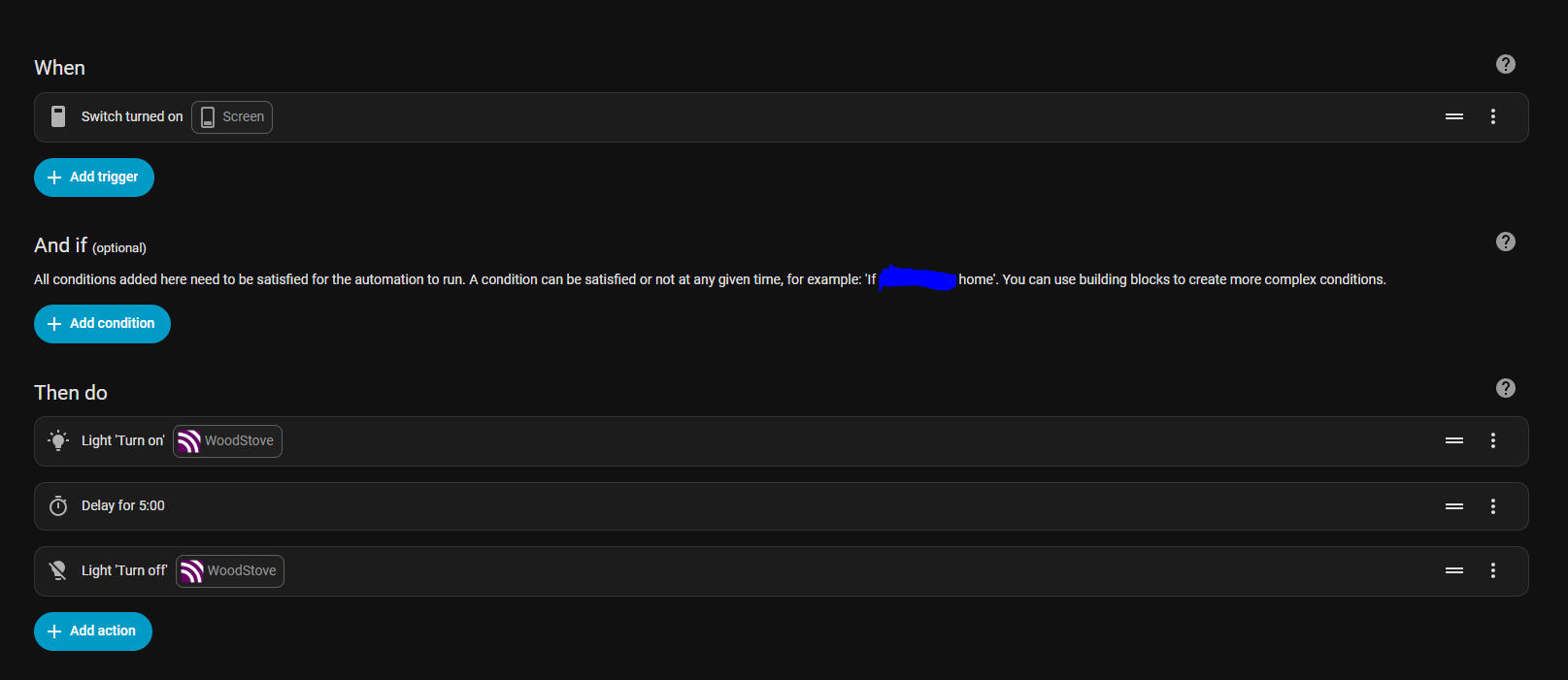

New Ha user,
Trying to save code
triggers:
  - trigger: switch.turned_on
      entity_id: switch.galaxy_tab_a_2016_screen
    options:
      behavior: first
conditions: []
actions:
  - action: light.turn_on
    metadata: {}
      device_id: 89a31d42475f61a901d4eb59583b1a2b
    data: {}
  - delay:
      hours: 0
      minutes: 5
      seconds: 0
      milliseconds: 0
  - action: light.turn_off
    metadata: {}
    data: {}
mode: single
and I recieve the following error when I test in Developer tools
This template does not listen for any events and will not update automatically.
switch.galaxy_tab_a_2016_screen is coming from Fully Kiosk integration and light is a mqqt entity that works fine. Goal is to turn light on when display turns on.

Still did not save
alias: "Galaxy to woodstove light "
description: ""
triggers:
  - trigger: state
    to:
      - "on"
conditions: []
actions:
    metadata: {}
    data: {}
  - delay:
      hours: 0
      minutes: 5
      seconds: 0
      milliseconds: 0
    metadata: {}
    data: {}
mode: single
ps. As mentioned I am new to HA and was just trying to use intuitive Automation creator.

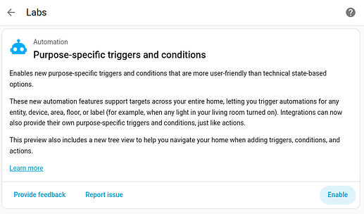

I believe they enabled this experimental feature:
“Purpose-specific Triggers” are not yet part of the documented list of Triggers.
It’s the second example I have seen recently that uses these new Triggers and both users reported problems with their automations.
I don’t recommend new users try experimental features.

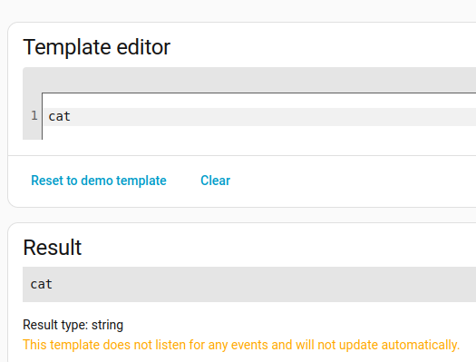

It’s not an error.
The Template Editor simply tests Jinja2 templates and nothing else (i.e. it does not test an automation’s YAML code). Your automation contains no templates and so you get that message.
Example:
Note the message at the bottom.
