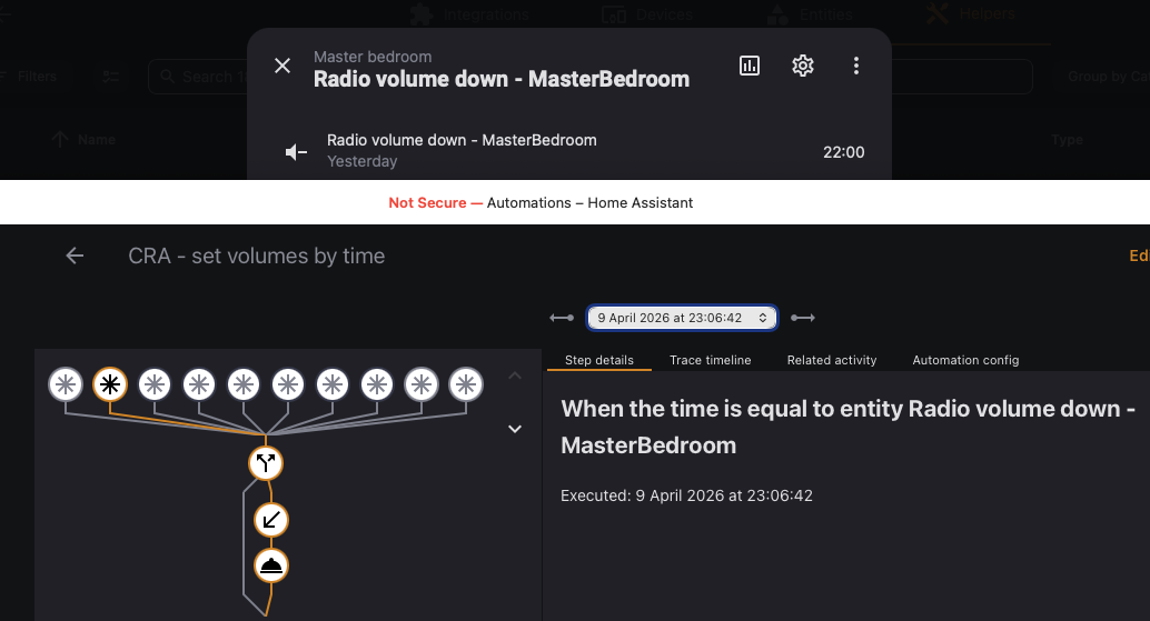

Ok, another oddity. I’ve just noticed another Automation doing the same thing.
This one has multiple triggers, some of which seem to be triggering when they should, but just seen the Traces of a couple of triggers that occurred late - bizarrely the exact same 1 hour, 6 minutes and 42 seconds late.
I wondered if maybe the recent change from BST back to GMT (UTC) might be involved, but that’s an exact 1 hour and only some triggers have been affected.
What’s so special about 66 minutes?
Here’s a screenshot of the trace showing when it was triggered and in the background is the window showing the actual value of the input_datetime it is using for the trigger.
It is simply not being triggered when it should be and no script calling in this Automation so that’s not the issue.

These are the last few traces of this Automation:-
The latest one is the correct time, but all the earlier ones are 66 mins and 42 secs late. That’s 4,002 seconds.
WTF?
