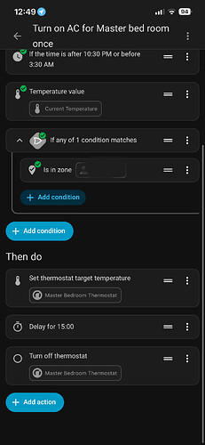

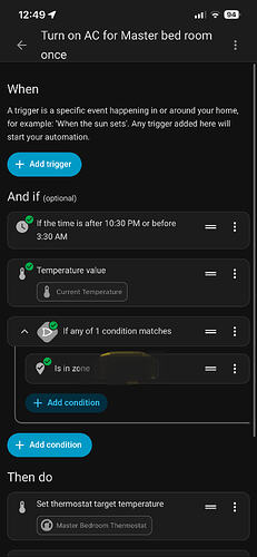

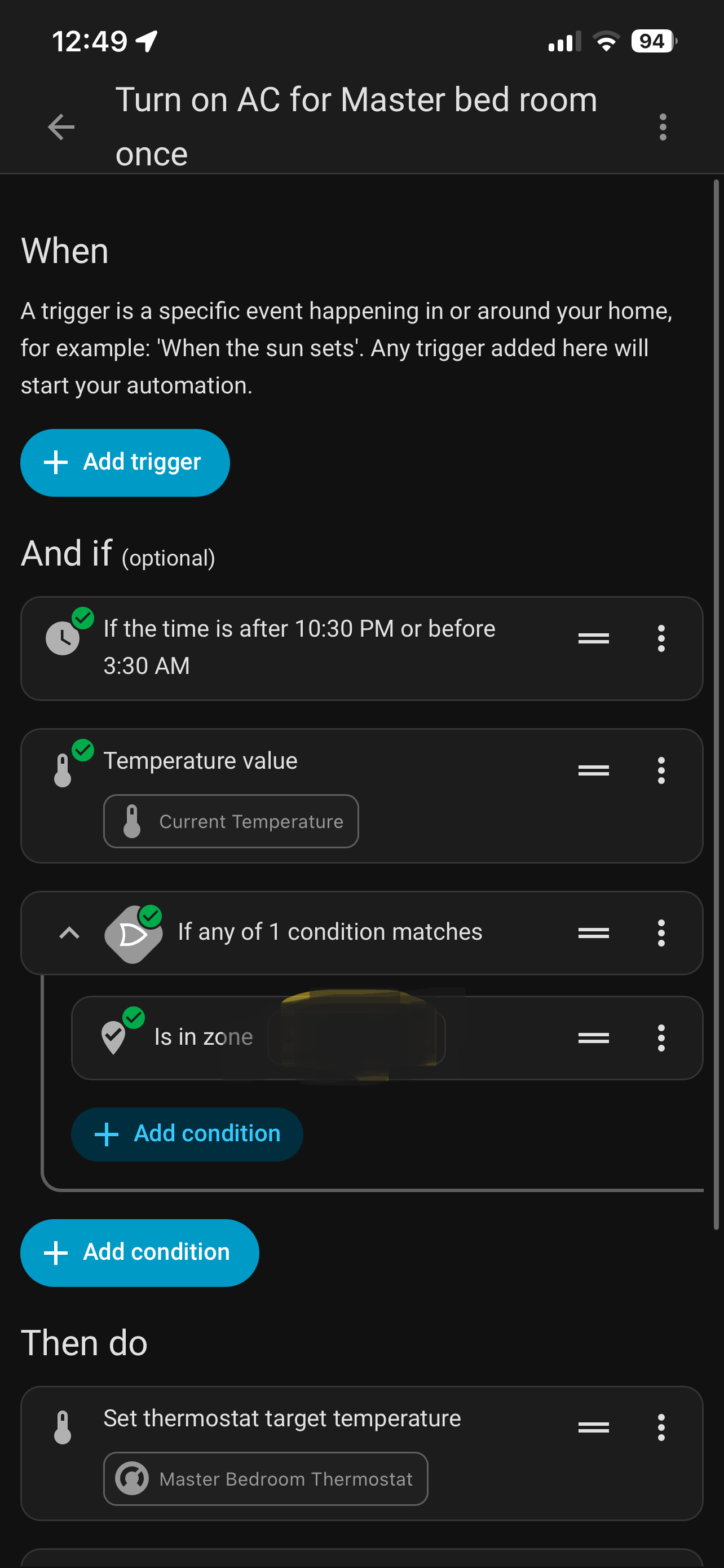

Hi, i have several automations that are not firing though the conditions are met when i check them. What could be the issue?

Firing = triggering…but you didn’t show the trigger(s)?

You don’t have any triggers in your automation. How do you expect it to trigger?
Also, please don’t take screenshots of automations. Post them here as yaml & format it correctly.
