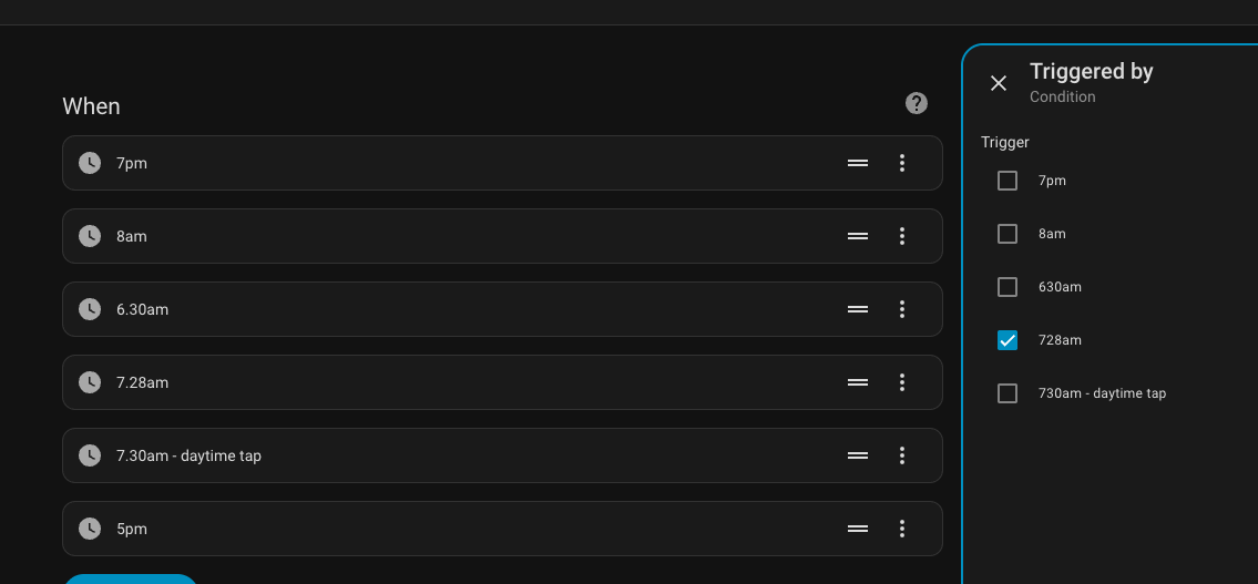

Automations not seeing new trigger
As you can see i have a list of triggers, but cant see the 5pm trigger in the options to trigger an item.
This 5pm trigger has been added after the automation was made previously. I’ve saved and come out of automations and gone back in, ive even rebooted HA to see if that clears it through.
help please?
I’m guessing you added IDs to the other triggers but forgot to do that on the new one.
But as always. Post the correctly formatted yaml to get the best possible answer.
i renamed it but forgot to add the ID, thank you. such a simple mistake.
