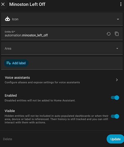

My devices show up on my Dashboard but not my automations. I am not familiar with editing yaml and the devices have a add to dashboard option but not the automations for some reason. Can someone help? I tried to follow another post similar but cannot really understand it. It says its supposed to be visable.
Automations are based on triggers. Meaning something happened. They don’t make sense to be on a dashboard.
Please explain your thinking so we can help move you forward.
