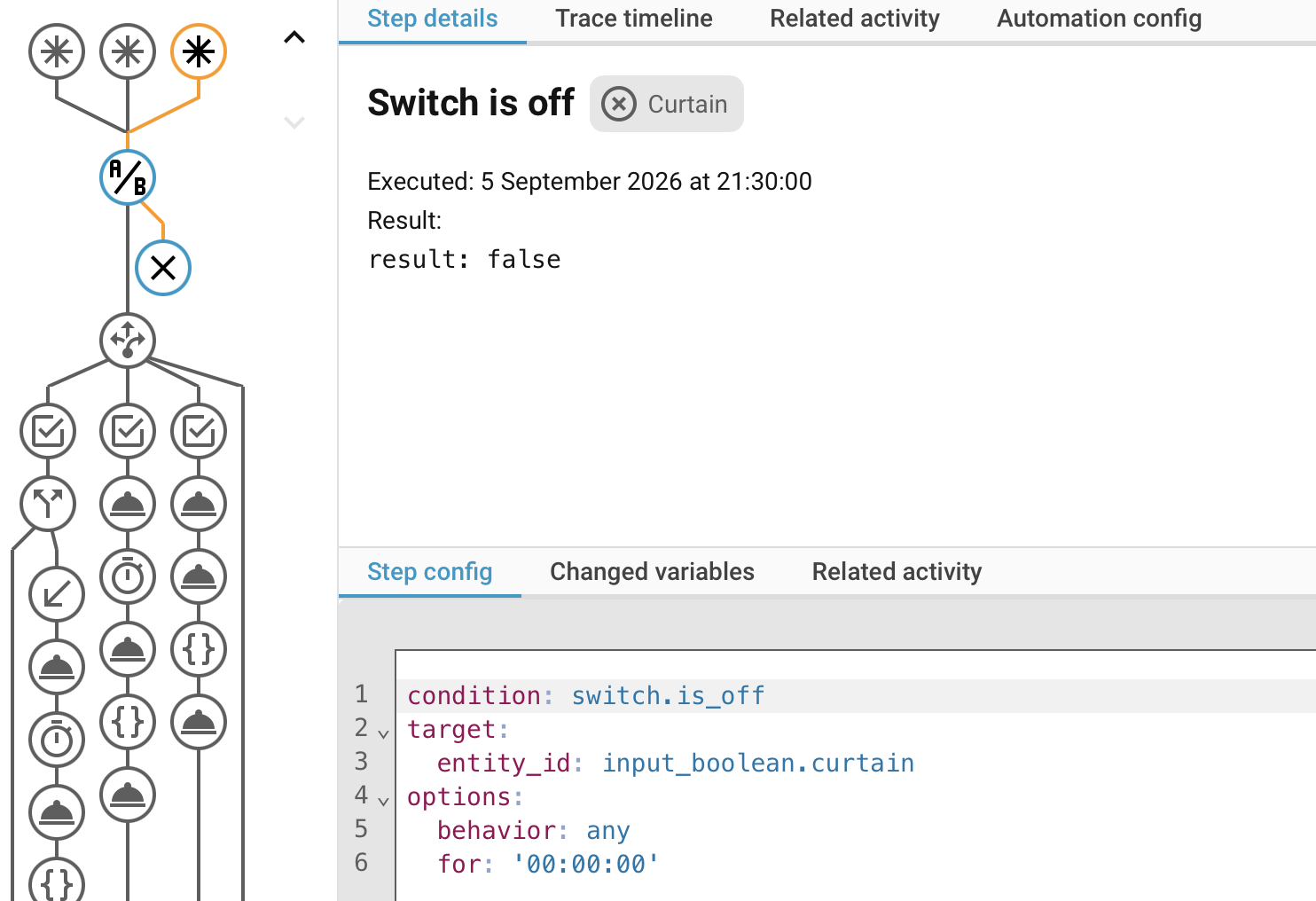

Here is a screenshot showing the trace where it stopped:
The biggest problem is the wait_for_trigger combined with mode: single…
Every successful branch eventually does this:
- wait_for_trigger:
    - trigger: time
      at: '23:59:00'
That means if the automation fires at 16:45 or sunset, that automation instance stays alive until 23:59. Because it is mode: single, any later trigger is ignored while that instance is still running
So the 21:30 safety trigger is effectively dead whenever an earlier branch ran successfully.
Home Assistant explicitly treats single as one active run at a time
Next lesson: avoid long waits if at all possible…

Either way, I’m not sure whether the error reported in the trace is correct. It ran at 21:34, which is 4 minutes later than the cc_late trigger. Maybe there’s another automation (maybe automation.curtain_close_master)which is interfering with this long-running wait, but it’s certainly not this one. If it were, it’s would have failed at 21:30 & left a clearer message in the logs.
Yeah that was intentional. Whichever of the 3 runs is successful turns that boolean on. A subsequent run same day checks that boolean. It ran at 16:45 and exited (sunset not true), it ran again at sunset +15 and completed all actions before the wait, it ran again at 21:30 and exited due to the boolean being on (triggered by the sunset +15 run) as expected.
21:34 is the sunset +15 run stopping. The ‘cc late’ trigger started a run which exited as it should:
