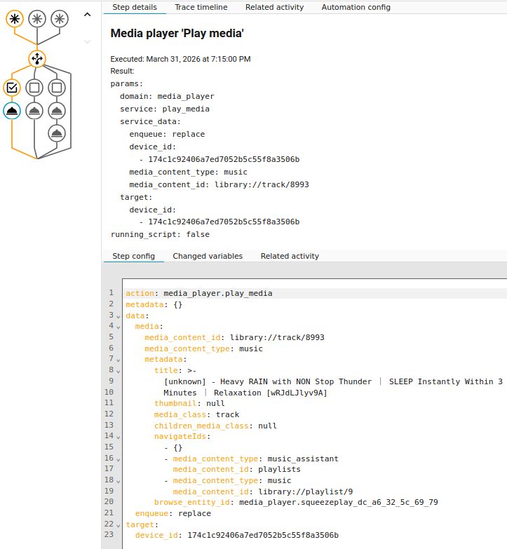

Maybe the automation didnt trigger.
Did you check the traces?

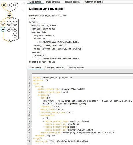

Yeah. Here’s tonight for the kids room where it changes to rain noise at 7:15.
And this is the timeline:
Notice that it didn’t play… it turned idle… And I was watching it! So I had the automation open and I hit “run action” :- worked right away.
