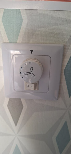

I have the following switch in a room and I would like to automate it.
Is that possible at all with switch modules? I guess yes for the light switch, but what about the fan knob? Any ideas/ suggrestion would be appreciated.
It depends on the fan itself, but I have 2 ZWave switches for each of my 4 ceiling fans (I live in South Florida). One is for the light (dimmer) and one for the fan (this off-low-medium-high).In some cases, I needed to cut out from the wall to add a second switch, but the result is excellent.
