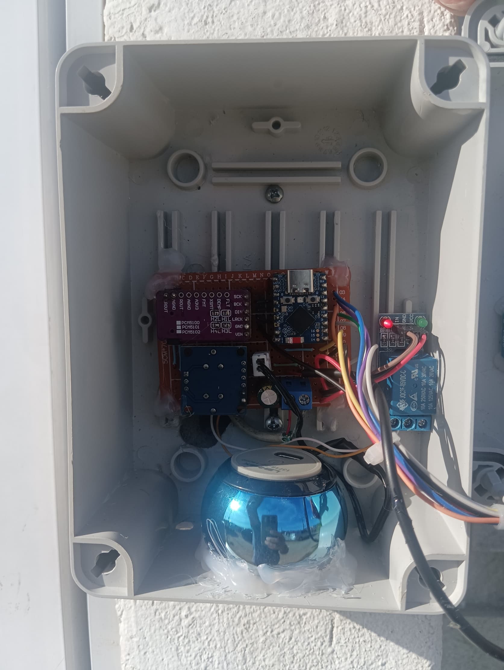

Hardware and “Root-Level” Engineering

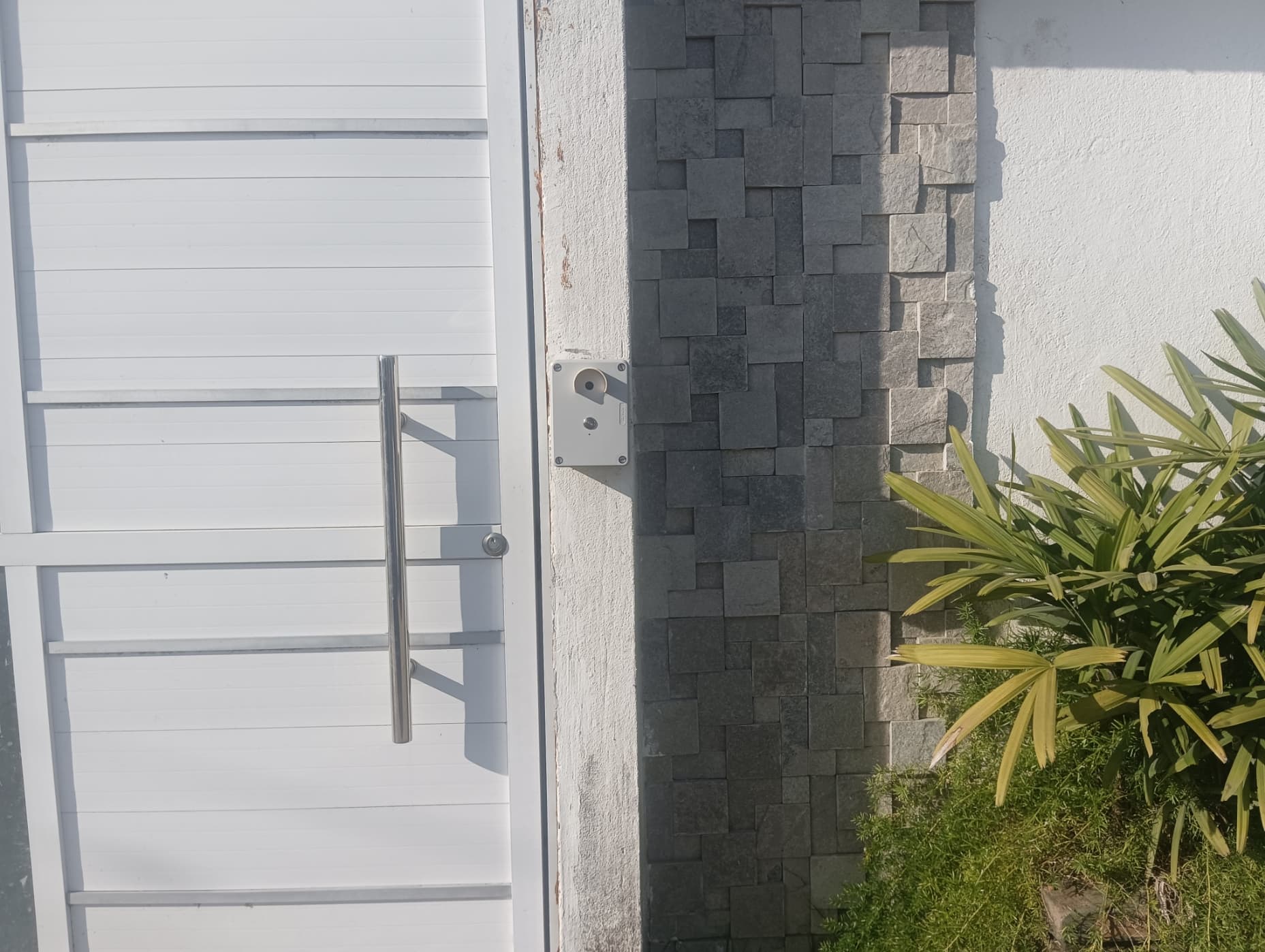

Enclosure and Protection
To house everything, I used an IP65-rated enclosure to ensure weather resistance.
It may not be the most elegant design in the world, but it’s extremely functional and secure.
The Secret Behind the Sound
Since the intercom sits directly on the street, I needed the AI audio to be loud and clear.
So I did a “transplant”.
I used the full acoustic chamber from a cheap TWS Bluetooth speaker.
I removed the battery and original electronics, keeping only the 3W / 4Ω speaker inside its original acoustic chamber.
This provided sound pressure that would be impossible with a loose speaker inside the box.
I2S Audio
The signal goes through a PCM5102A DAC and a PAM8406 amplifier, eliminating Wi-Fi interference noise.

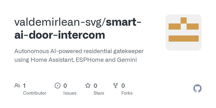

Documentation and Code
I organized everything on my GitHub repository, including:
• hardware photos
• demonstration videos
• wiring diagram
• ESPHome YAML
• Home Assistant automations
• AI prompt
