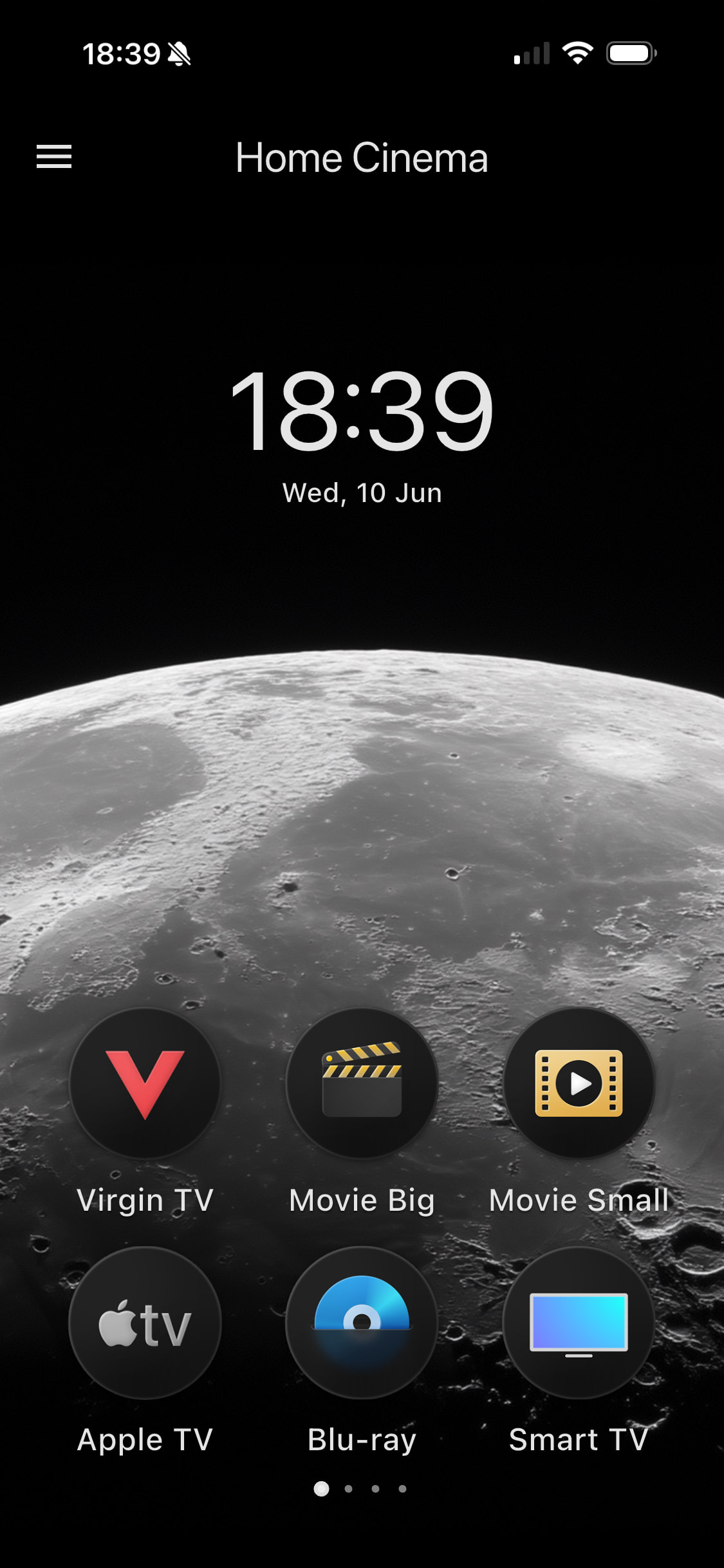

I have recently setup HA with a ton of complex integrations for a Home Cinema. I am migrating from proprietary RTI handheld deal only configured device to the AVA Cinema Remote as don't want to use a tablet/phone remote.
Has anybody done much integration work with HA and Ava? I'll be happy to share my work once I get it going.
As background Ill be controlling
Amps, Blinds, Lights, Projector, TV, Multiple screens, Blu-ray player, Apple TV, Cable TV box, Air con, Sonos, Temp/Humidy etc which is all setup in HA

I’ve setup AVA over the last 72 hours and have integrated it fully with HA
Many videos say launch the HA companion app
Don’t do that use Webhooks
If anybody wants to know more ping me
