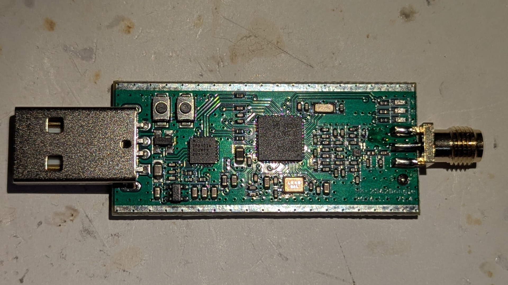

I bought a Avatto GW70-Ti Zigbee 3.0 USB Dongle Amazon.com: AVATTO Zigbee 3.0 USB Dongle,CC2652P Chip, Zigbee Coordinator/Router for Home Assistant, Zigbee2MQTT, ZHA : Electronics (with a TI CC2652P chip inside) hoping to use it as a Zigbee router (repeater) in a Home Assistant setup.
I was able to program it with the Z-Stack “router” firmware without taking the case apart using BOTH the Sonoff web flasher and the SMLIGHT web flasher. The SMLIGHT web flasher produced a log file. Is there a way to attach text files to these posts?

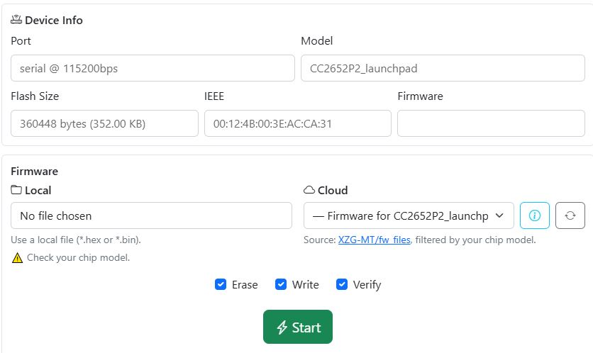

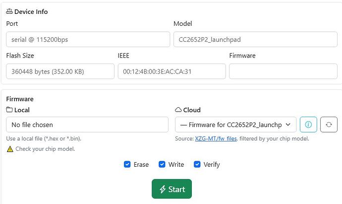

I also tried this web flasher https://mt.xyzroe.cc and it worked too.
It allows you to read device into and what firmware is in it.
It all looks good.
I reprogrammed it with the XZG Mult-tool and it appeared successful.
