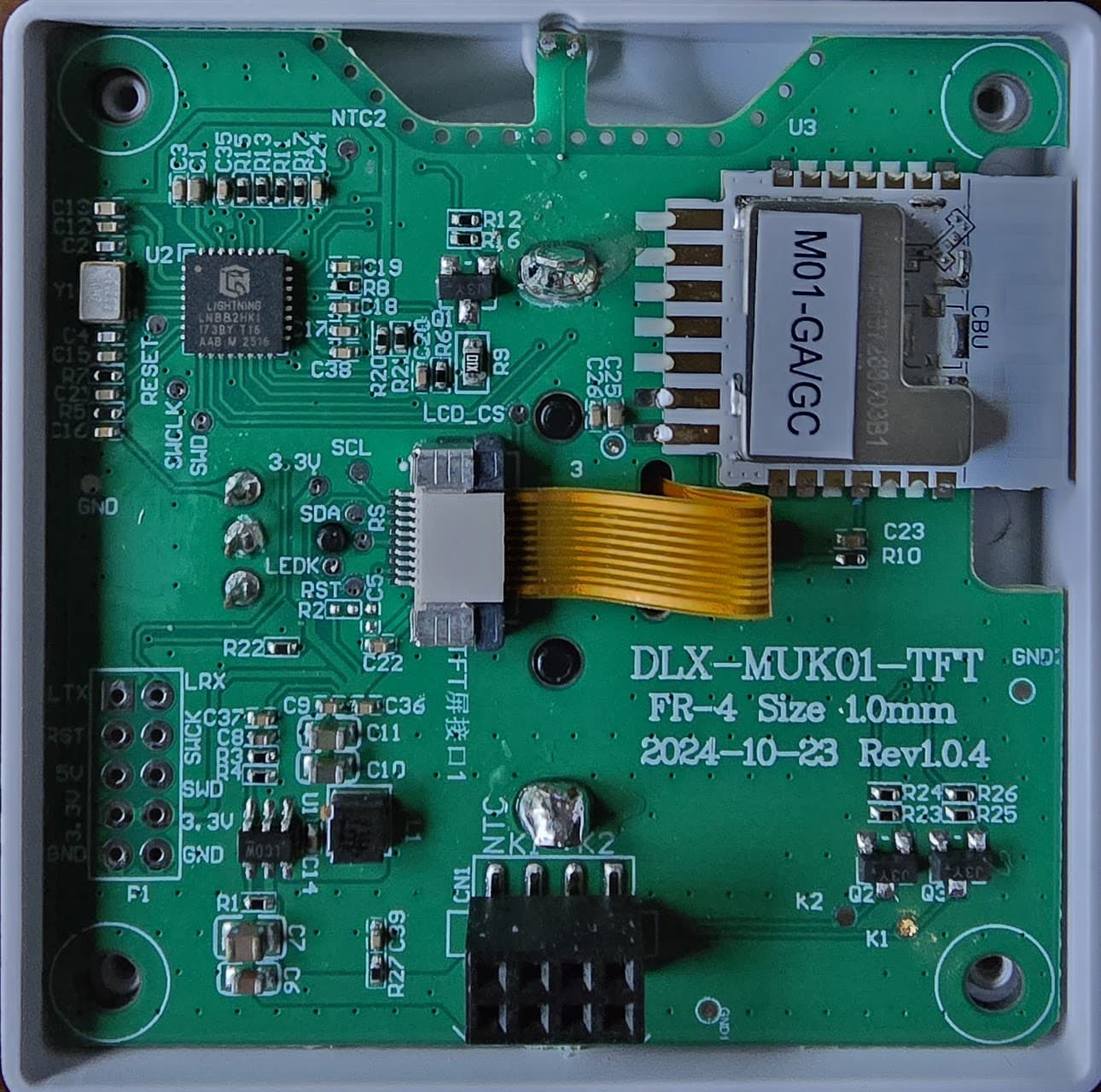

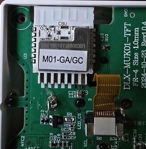

I checked the PCB of the thermostat. The connection module is labeled as CBU.
CBU Module Datasheet-Tuya Developer Platform-Tuya Developer
Is there any way to install ESPHome or OpenBeken wirelessly?

The CBU module you found is not Wi-Fi – it’s purely a Zigbee communication module (as confirmed in the Tuya datasheet: CBU Module Datasheet-Tuya Developer Platform-Tuya Developer).
The actual Wi-Fi functionality is integrated into the main controller, the LN882H(K/I) chip.
That’s important because LN882H is supported by ESPHome through LibreTiny:
I don’t know whether any public alternative firmware already exists for this specific device, but the hardware platform is workable with ESPHome, at least in principle. I’m considering looking into an ESPHome implementation, although I don’t have the device myself yet to investigate properly.
Do you have any additional photos of the board, especially the other side?
The key missing piece is the TFT display identification. Knowing the exact panel driver would make it much clearer how realistic ESPHome support is.
@jdobry I will take photos from other side of the PCB later on. That LN882H will be a pain in the ass to desolder and flash, if the Tuya-Convert will not work.
In my findings this CBU module should be also libretiny compatible? It should be able to talk with LN882H thru TuyaMCU component.
CBU - LibreTiny
