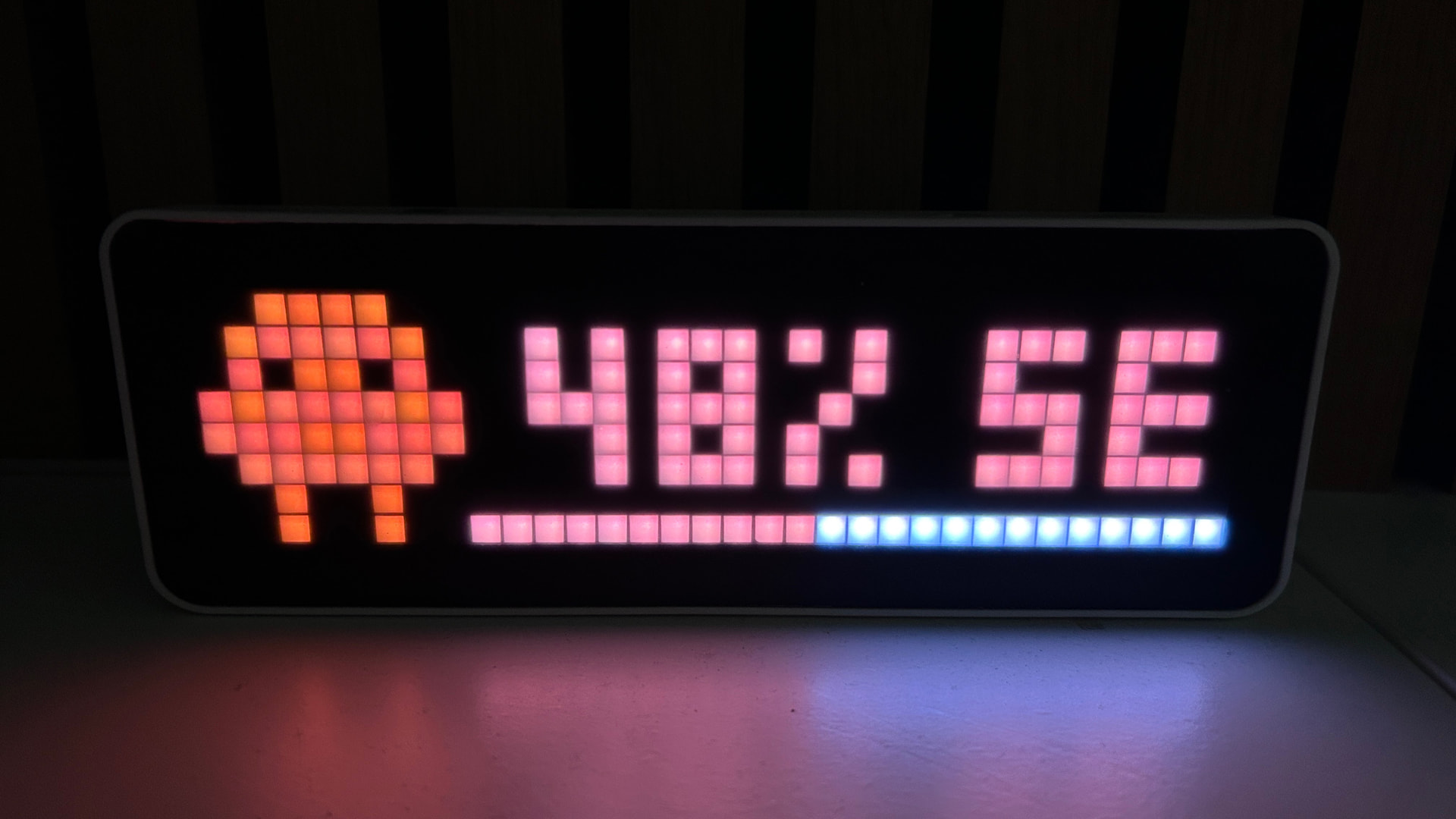

Display your Claude AI usage as a live progress bar on an Awtrix LED matrix - color-coded and always up to date.
What it does
Reads a Claude usage sensor (0-100%) from Home Assistant and pushes it to your Awtrix device via MQTT. The display shows the usage percentage alongside a progress bar, with text color that shifts from green → yellow → red as you approach your limits. Both thresholds are configurable.
The blueprint updates immediately whenever the sensor changes, and again on HA restart. If the sensor is unavailable, it gracefully falls back to an N/A state.
Tip: You can create this automation multiple times — for example once for weekly usage and once for session usage, each with its own app_name so both apps coexist in the Awtrix display rotation.
