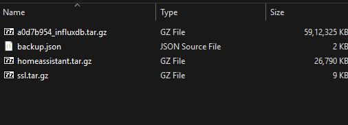

I must admit, I don’t understand HA much, the MariaDB shows 110GB but the backup has only 41GB. 180GB is used from total of 250GB something nvme on HA running on Intel NUC. I suppose InfluxDB backup of lots of .tar.gz files is around 6GB from this script as well as HA backup method of that addon but, yes HA created backup has 3 more files.
First InfluxDB tar.gz, I assume it to be a single influxdb tar.gz file instead of split files (shard files) that InfluxDB backup command has created when this script is used. So I assume, if I have to restore it to HA, I need these extra files as in screenshot, for non-HA the backup from the script is fine.
At this point, yes, this script without extra files should not function during restore to HA.
