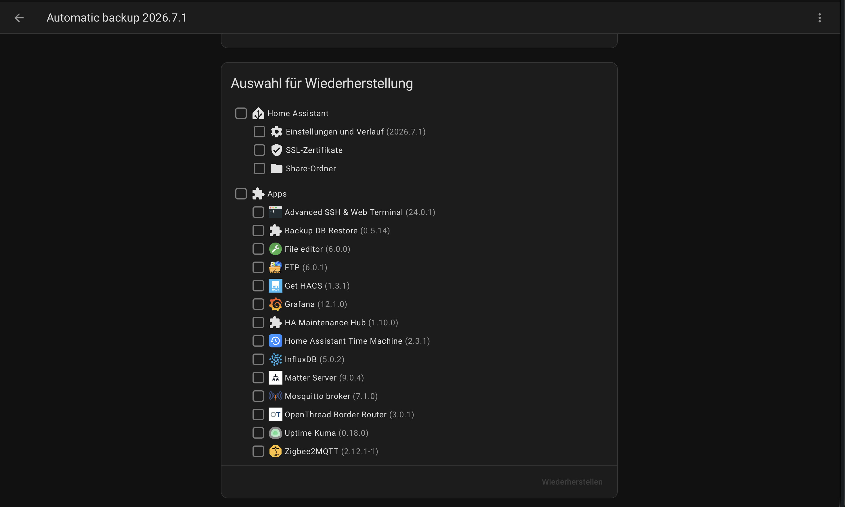

I have a problem—I can't upload my backup. The moment I click "Upload," I get the following error:
error (mainthread) [supervisor.api.backups] can't write new backup file: connection lost
I can't upload the same backup to my old instance either, but I can start a restore from it. See screenshots:
I'm a bit lost; I can't
Backup file is 10 GB big. However, I've uploaded backups as large as 30 GB in the past without any problems.
