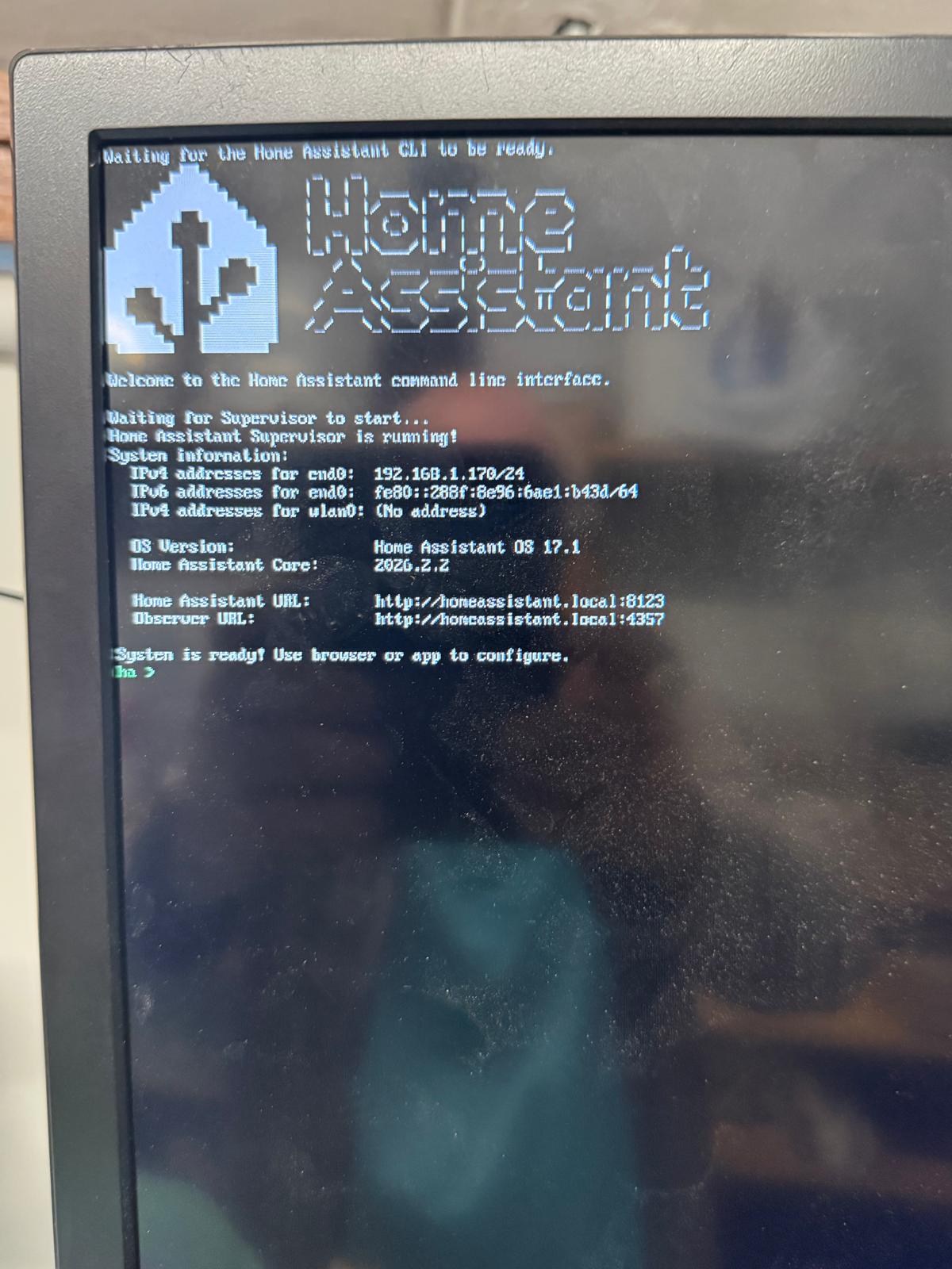

What does your welcome screen say? The one where you type your CLI commands. Straight after boot is finished before you type anything in.
A clear readable screenshot/photo would be sufficient.

I hope it’s clear enough.

The welcome screen looks OK. Hope there were no errors that halted your startup process, but they usually halt progress. I note the update is still on the 2026.2.2 version. Do not initiate any commands from the CLI screen at this stage to tickle it.
What happens when you connect to your Pi via your local network on a browser set to http://homeassistant.local:8123
How about http://192.168.1.170:8123 ← your specific Pi network address showing on the welcome screen
Check you have quality USB cables between your Pi and the USB converter and SSD. As @Arh suggested, you may wish to consider a small powered USB3 Hub to take the load off the Pi power supply USB Ports, especially if you have other peripherals connected also.
