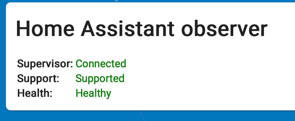

Yes I can access the observer.
This looks ok to me.
