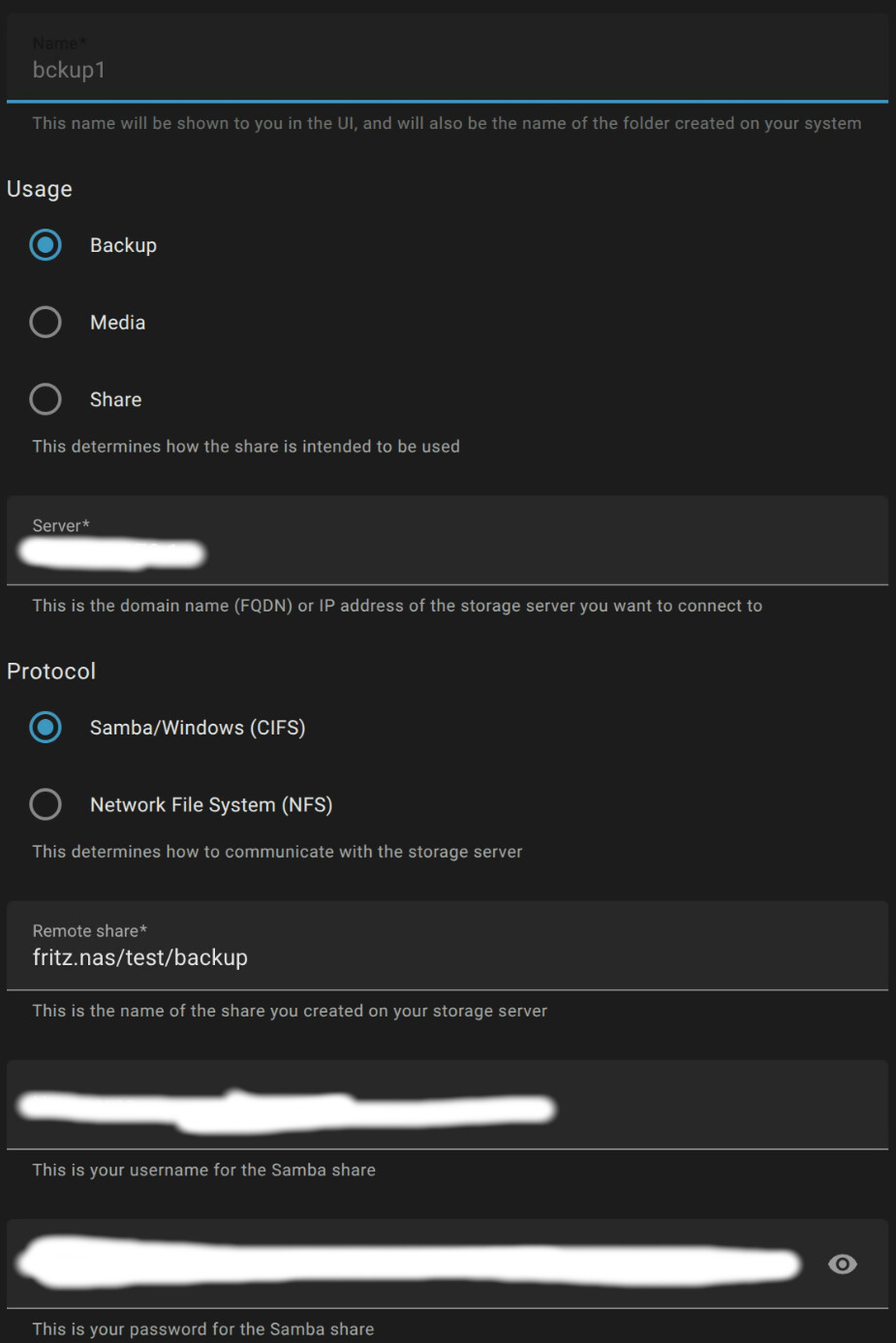

Can you show us your HA backup path defintion ?

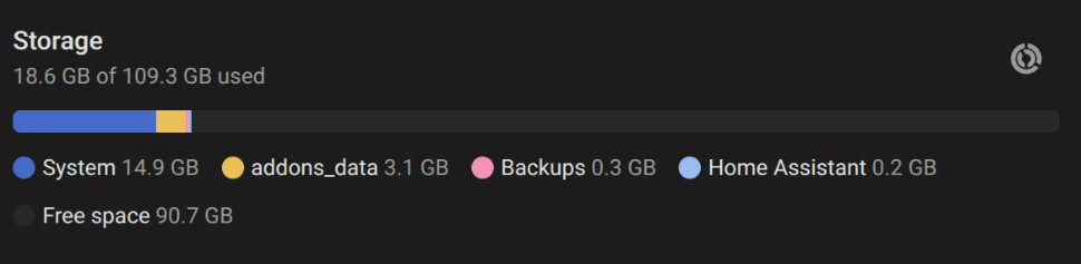

this is my remote location for the backup but today is failing to bnackup also on the local storage
What is happening?
The share definition on the FritzBox will not work this way. I also struggled with this. What is working for me is to use the complete Windows path of the attached storage device. In my case this is
FB-Basis/PortableSSD/9 Backup/HA
where FB-Basis is the individual name of the router, PortableSSD the name of the attached device and 9 Backup/HA the directory on the device.
You won’t need credentials in this setup.
