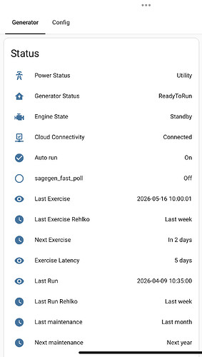

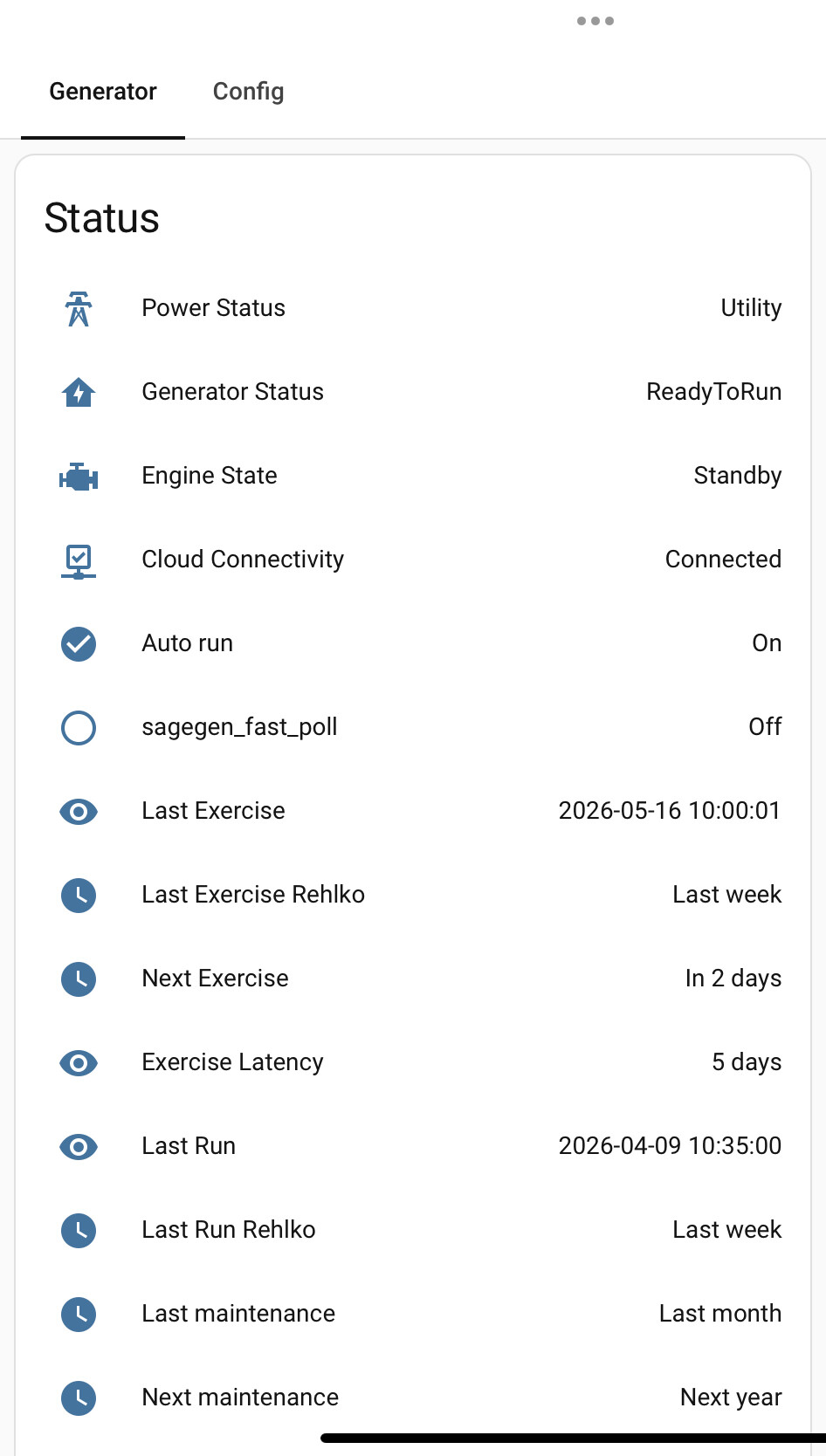

Get a kohler and you can use the Ha Rehlko integration I wrote.
