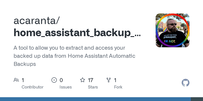

I was going to suggest trying this, AFTER you had checked the files were intact, you listed any error codes, your platform was stable, and nothing corrupted.
It makes a lot of assumptions that everything is in place and functioning and I strongly recommend you eliminate them as potential sources of error FIRST, but may suit your requirements. You may have to dig out the the underlying concepts and do the hard work yourself.
Ironically, a third party tool.
You may find useful hints here as well that I’m sure you have studied hard, but others may not have stumbled over, in addition to the important ones already suggested by @Sir_Goodenough
I used a third party tool. Thank you for suggesting a solution.
