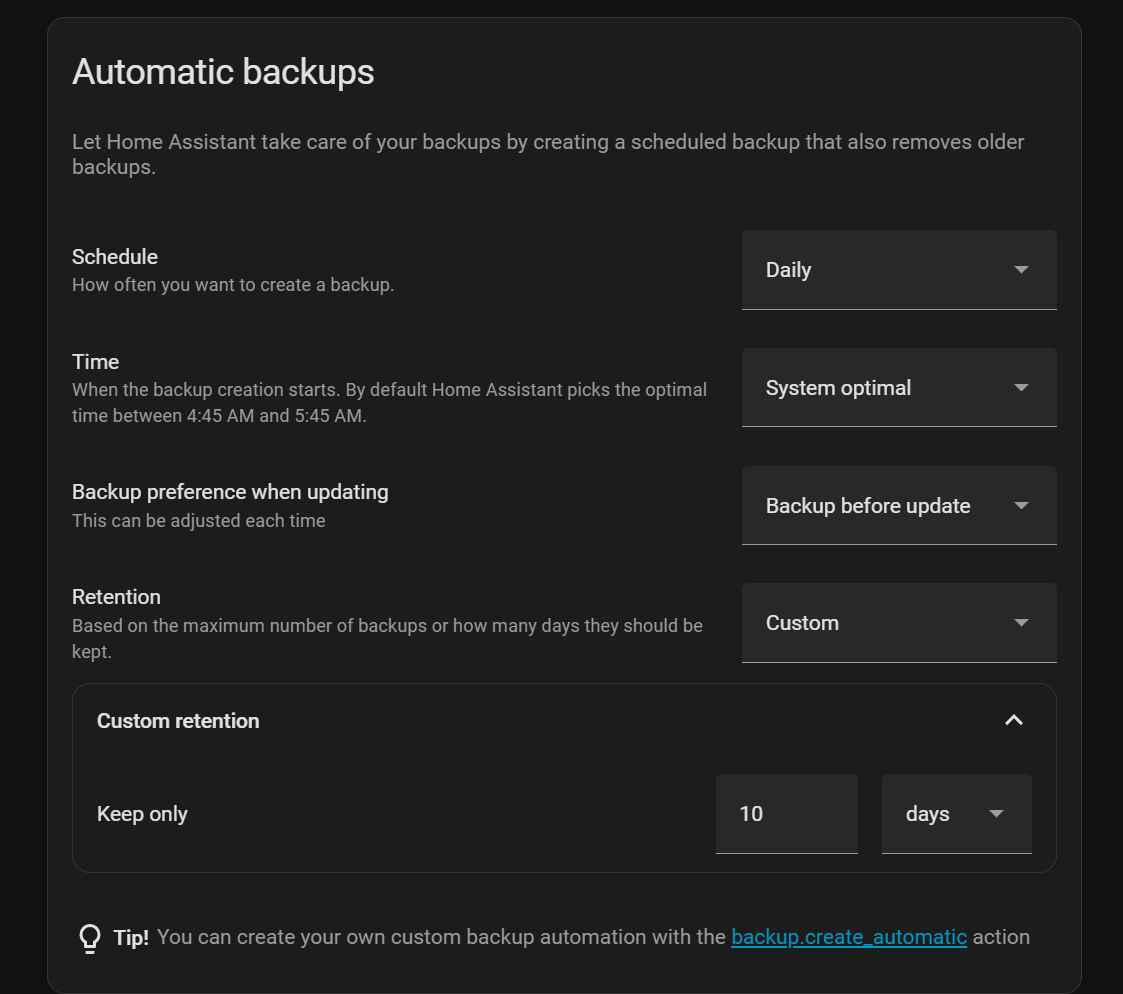

I’m having an issue where my retained backups are not being pruned according to my settings. I’ve searched the forum and see several other posts about this but none of them seem to contain a resolution relevant to my situation.
My local backups are configured to only keep the last 10 backups.
I have the google drive integration installed to handle offsite backups, with a custom retention of the last 30 days. I have not yet hit my G Drive retention number so I’m unsure if the lack of pruning also applies to non-local backups. Pruning does seem to be working for the add-on backups (which is set to only keep the last 3).

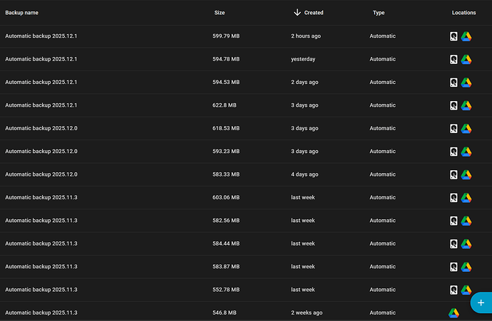

The number of backups showing in the GUI tracks with the number of local backups available on the local disk.
However there should be only 10, not 12. Deleting the backups from the GUI does delete them from the disk so HA seems to be able to manage the backups just fine.

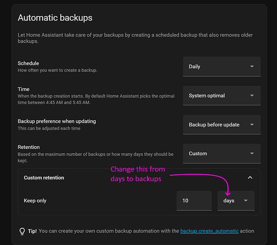

The time period covers 10 days as you specified. You made more than one backup on some days though. If you only want to keep a number of backups instead of time defined purge then do this:
Also do you really need three addon backups?
Reverting to the previous version is all you need and that only takes one backup.
oh jeez, duh lol. I’m embarrassed I completely missed that. That makes sense, those are my pre-update automatic backups.
