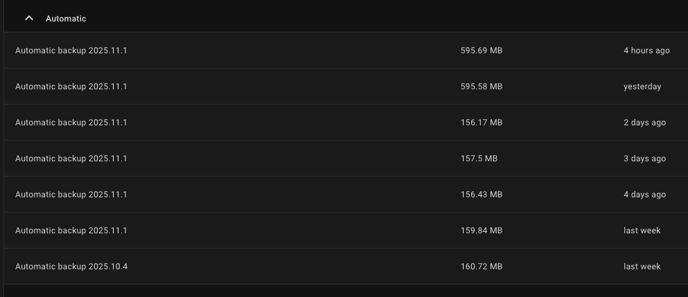

I am currently receiving a notification that disk space is running low. This is a HAOS install. I never had disk space issues before. My recorder database size is only 64MB. Following other steps in the help article about disk space, I noticed that my automatic backups suddenly increased in size from about 150MB to 590MB each day, starting 2 days ago.
How would I figure out what is causing this? I think I remember installing some updates a couple of days ago, including Whisper and Piper and a few others, but do not remember all of them. I have not installed any new addons or integrations in that timeframe.

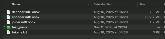

I’m guessing this is the model: encoder.int8.onnx? It is a huge file in the backup, everything else is just config-type data.
I have whisper set to the auto model, but this only happened after the recent update, previously, the .onnx files were not included in previous backups. Almost seems like it might be a bug in the backup mechanism or the add-on.
