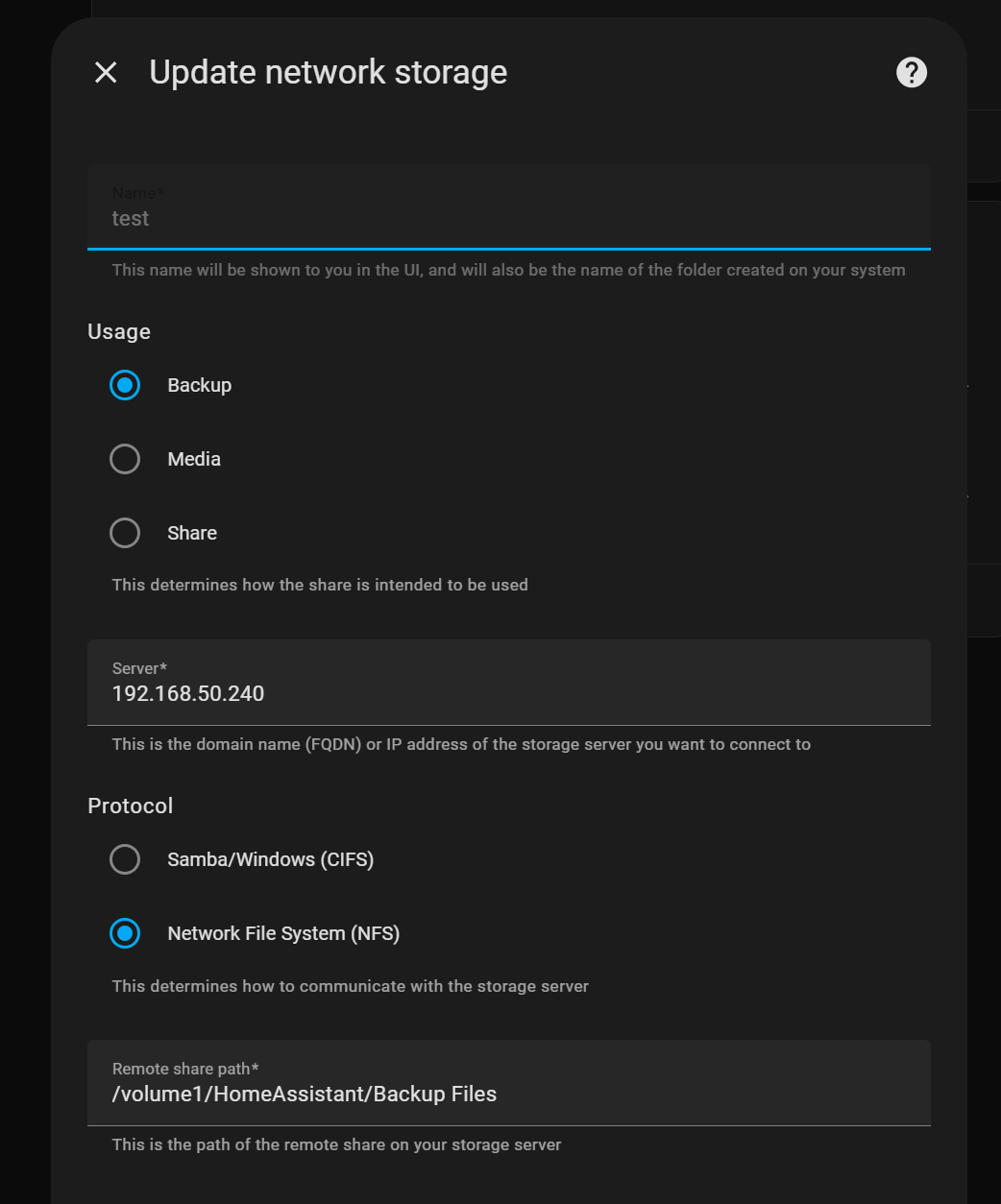

Getting this error. I believe the NFS settings in Synology are correct. See screenshot of HA setup.

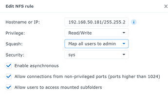

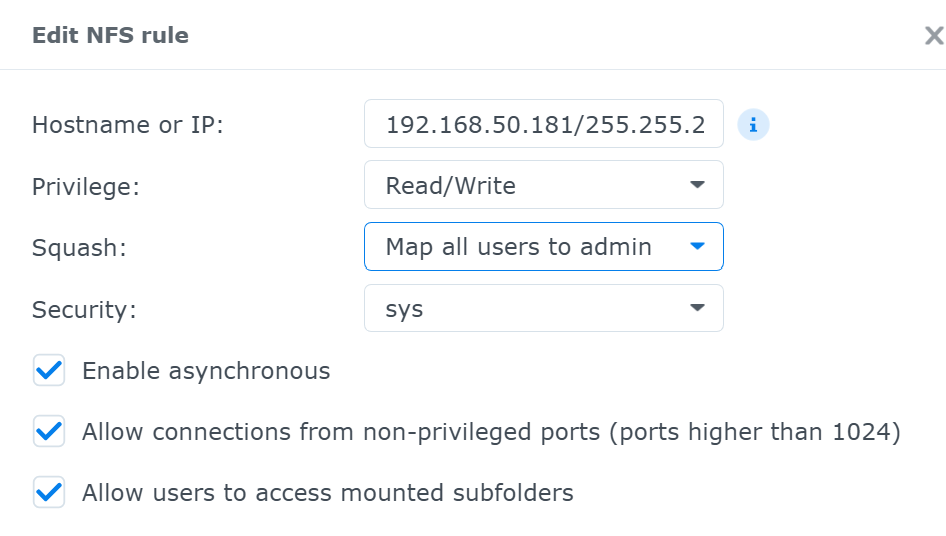

These sample settings for HA work with Synology and are similar to your posted settings.
Test mapping all users to admin for the backup folder’s NFS permissions and apply the necessary security if that works.
