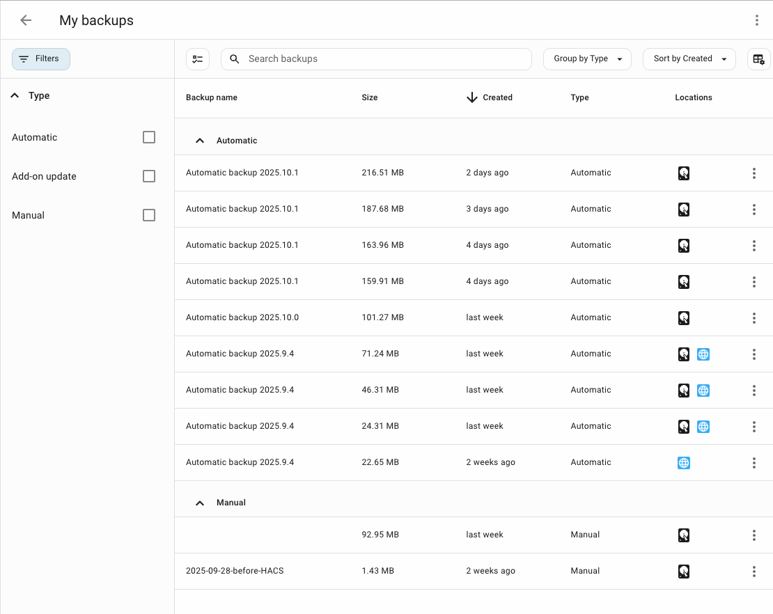

I am preparing to move to different hardware and went to check the backups and the “Creating Backup” and “Backup now” animations are spinning. This persists until I restart Home Assistant. After the first few successes, the backups are not appearing on NextCloud.
I have tried removing and re-adding the WebDav account and the situation reoccurs when I start a backup. I can see successful PROPFIND and GET requests from HomeAssistant in the logs.
Curiously, I just noticed that the change in behavior seems coincident with upgrading to 10.0 and continued through 10.1 (see image).

Yesterday, I removed the WebDav destination and the backups fail to the local destination (which should be the only destination). Click-initiated backups, either “Automatic” or “Manual” (with only the local destination selected) do not complete.
