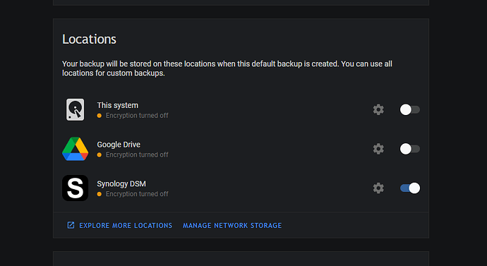

My case was a bit different from the OP. The issue disappeared after I changed the backup location from the NFS backup to the Synology Integration location. Just leaving a comment in case it helps.
Of course, I’m not really sure why it was resolved…
