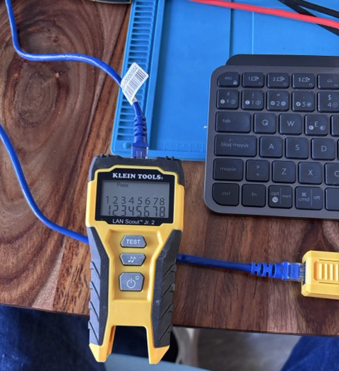

This is a good idea! I’ve tested the cable with a network tester.
It lacks shield, but all lines looks OK. I’ve already ordered some 0.9m cat-8 cables (they come with shield) so let’s see how it goes in a couple of days.

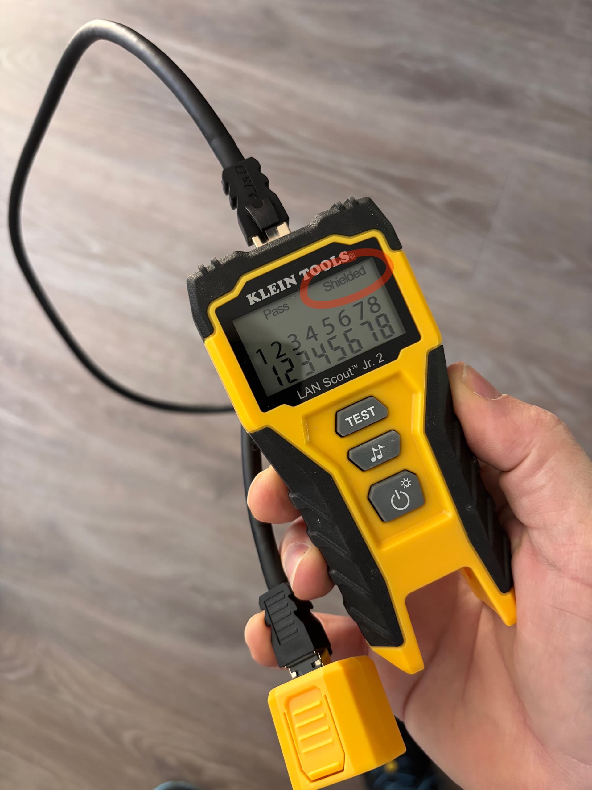

The new cables arrived yesterday. It is about 14 hours since I changed them and since then, no disconnections have occur.
The disconnections counter is there so I’ll be monitoring how it evolves but the conclusion at this moment is that I’ve had to use a shielded cable in order to have the Dongle-M in “stable” working conditions.
I’m not using WIFI on the Dongle-M and there is another WIFI AP a meter distance from the dongle-M, apart of that, the installation is underground so there is no interference from the outside.
