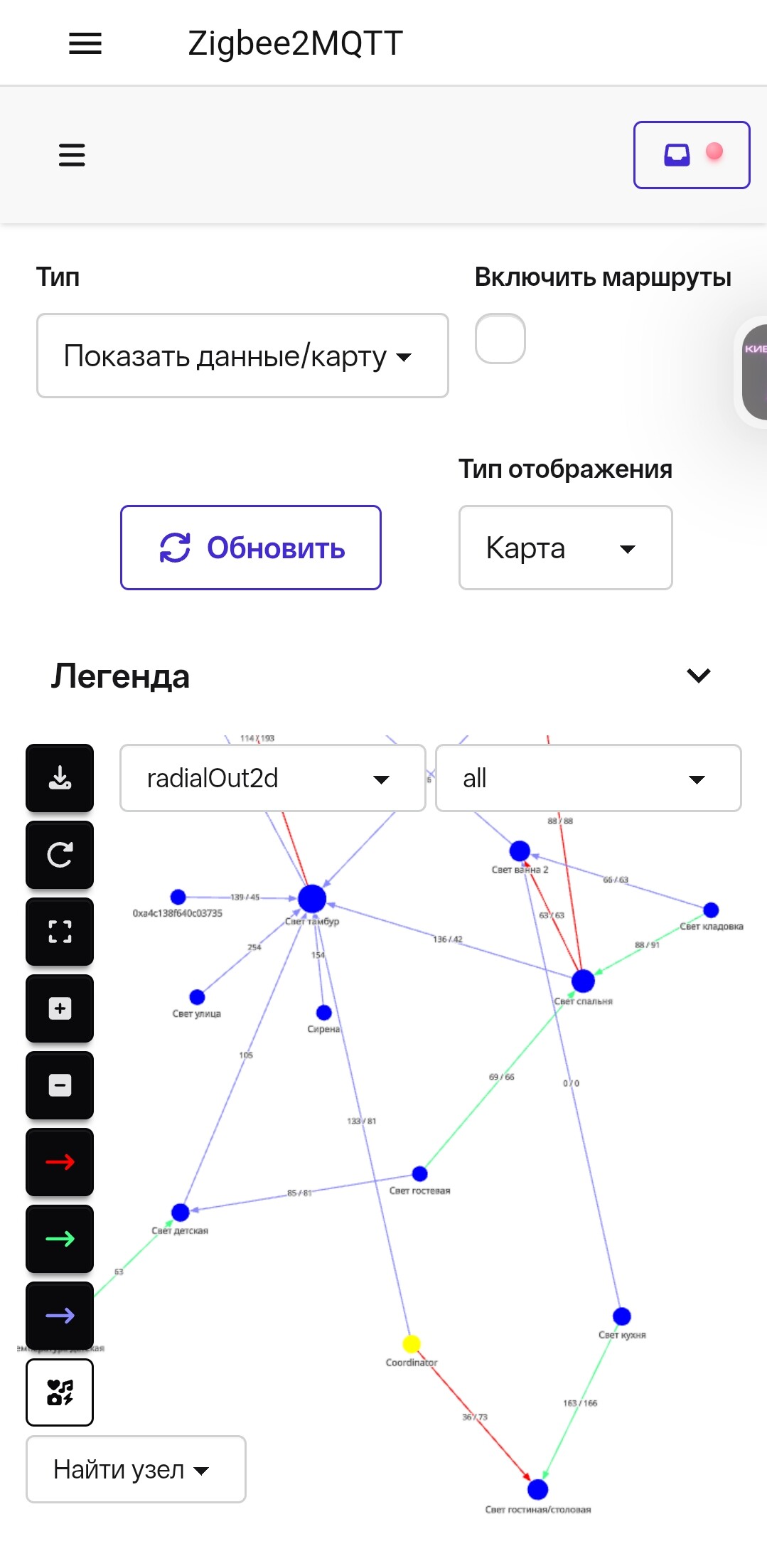

I've attached a screenshot. the coordinator is yellow in it. The coordinator is physically surrounded by router outlets (7 outlets at a distance of up to 3 meters), but it refuses to connect to them. and the coordinator is connected to sockets that are 7-9 meters away through 3-4 concrete walls)))
The coordinator is connected via TCP.
