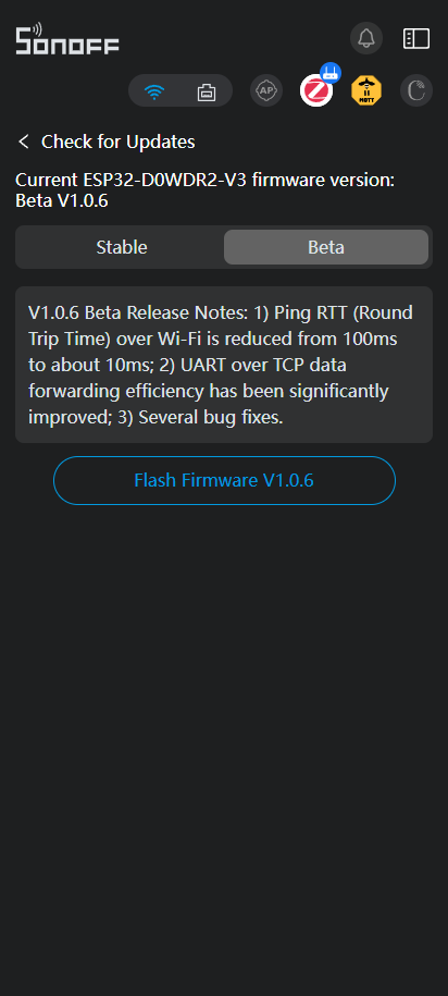

also @Zyxel @dominikprucha Thank you very much for your detailed report. We are doing 2 things right now:
  1. Buying UniFi PoE switch to test PoE compatiblity.
  2. Internal testing of v1.0.6 beta firmware, we’ll release it this week.
We are definitely going to solve these issues.

Thank you all for your valuable feedback and for your tolerance for SONOFF Dongle-M. Please believe us that we are working hard to debug the issues and fix the bugs.
We have just released v1.0.6 beta version. If you are still interested, please try it through Web UI -> Firmware -> ESP32-D0WDR2-V3 -> Check for Updates -> Beta -> Flash Firmware V1.0.6.
Note: You will need to refresh the Web UI after flashing v1.0.6.

I recently purchased the Dongle-M and had the same problems. Couldn’t get a stable connection with the UI due to a constantly resetting network connection.
With the 1.0.6 beta update all seems stable now.
It is connected via POE to a Netgear GC510P Switch.
