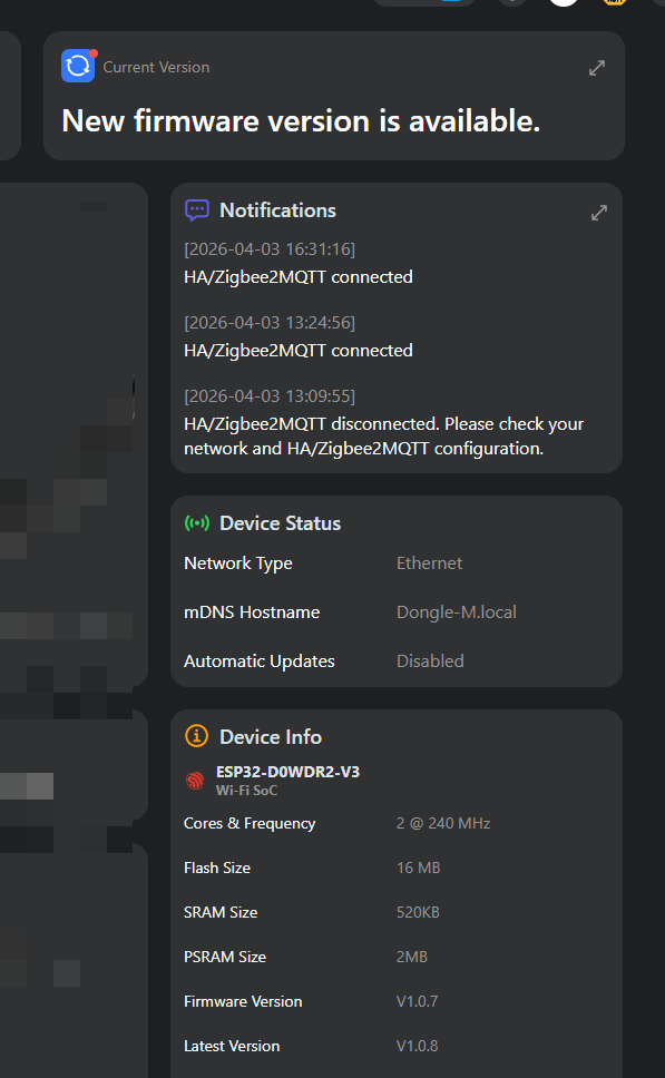

Could you add a clear Notifications button for web ui please
Got it. I feel the same need.

  1. My ESP32-D0WDR2-V3 already on STABLE V1.0.7, why does it still prompt New firmware version is available?
  2. Is Sonoff suggesting that everybody should be on BETA V1.0.8?
  3. If everybody should be on BETA, why is there a need for STABLE?
Please… let us prioritize proper fixes.
The ā€œNew firmware version is availableā€ shown here does not refer exclusively to the ESP32-D0WDR2-V3 firmware version; it also includes the version of the EFR32MG24. The version prompt appears in your case because the EFR32MG24 on your device is not yet running the most up-to-date firmware.

We have confirmed that the incorrect version prompt is indeed a bug. We will arrange to fix it in an upcoming beta release and merge the fix into a stable version when appropriate. We sincerely apologize for the inconvenience and the poor experience this has caused.

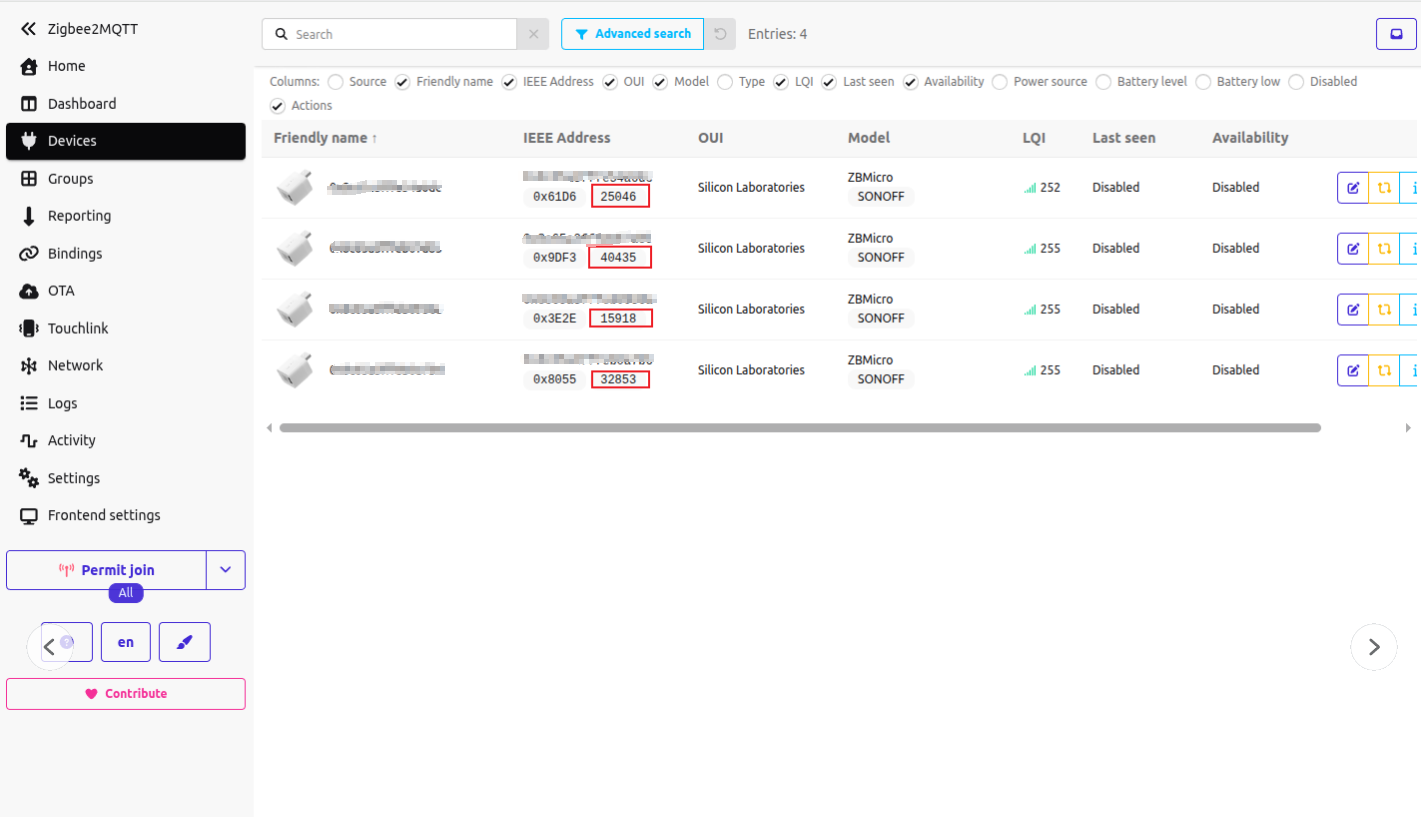

After reviewing the logs, we suspect that there are duplicate Zigbee network addresses in your Zigbee network. The conflict between the two devices using the same address is causing Zigbee2MQTT to restart.
At the moment, the conflicting address we can see is 0 (0 is the coordinator’s address), which means that there appear to be two devices in your Zigbee network using Zigbee network address 0.
Could you please check whether this is the case in your Zigbee network? You may refer to the image below for the location of the network address.

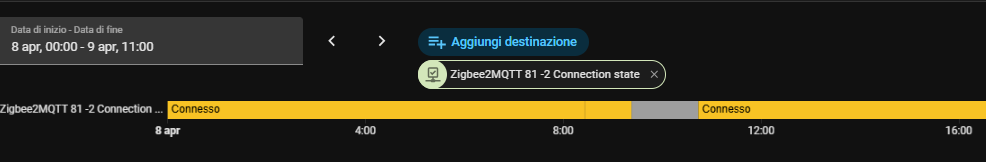

I think i got the same issue yesterday morning
Just restarted it by unplugging/replugging poe cable and back online.
logs looked like yours.
At the moment, we suspect that the issue may be related to PoE power supply, but we are still investigating and testing. Since we are unable to fully replicate your usage environment, it may take some time before we can reach a definitive conclusion.
Could you please try switching to a different network port, or use USB power instead and run it for a period of time?
  • If it runs stably, we can confirm that the issue is related to PoE power.
  • If the issue still occurs, please also download and provide the corresponding debug logs and Zigbee2MQTT logs to us. We will proceed with further investigation as soon as possible.
