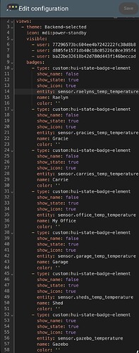

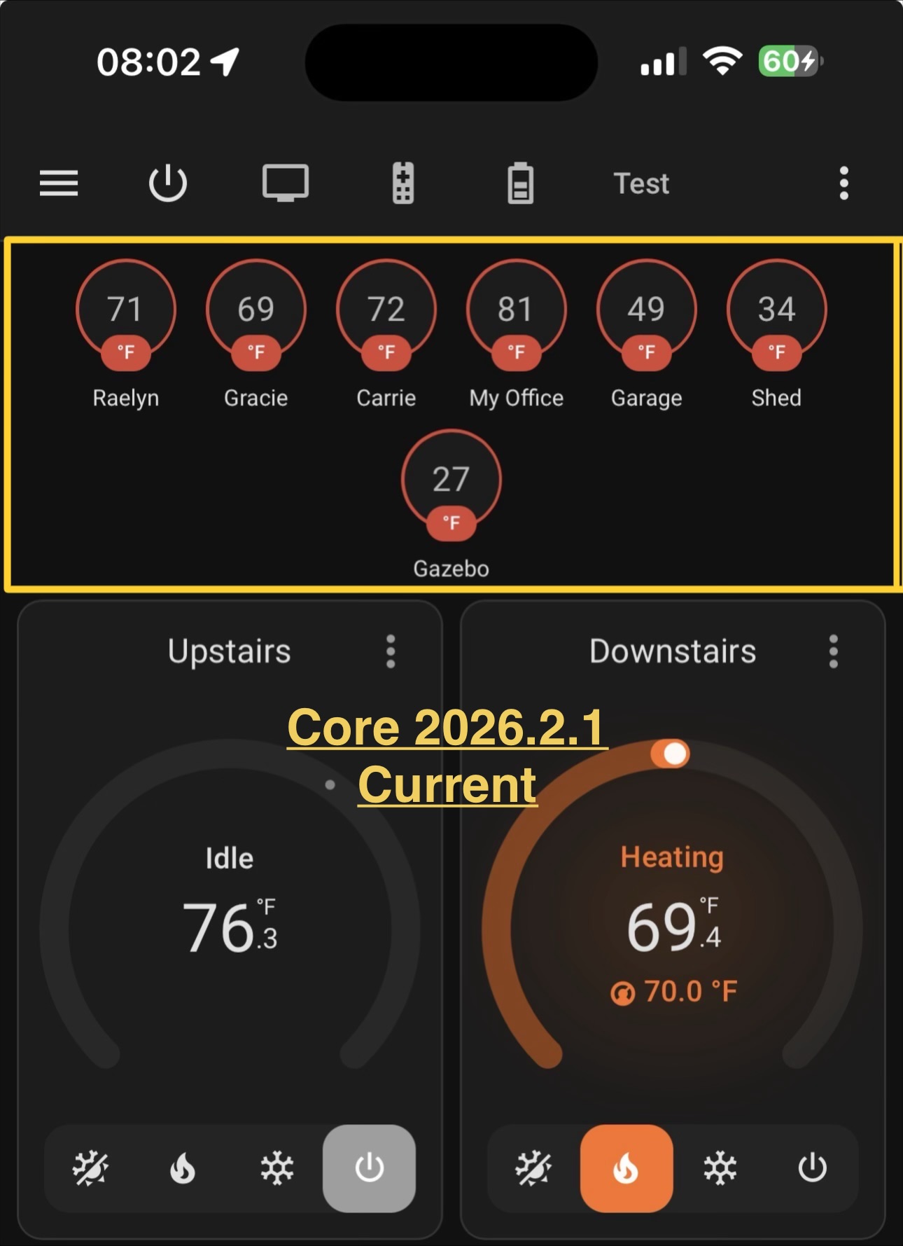

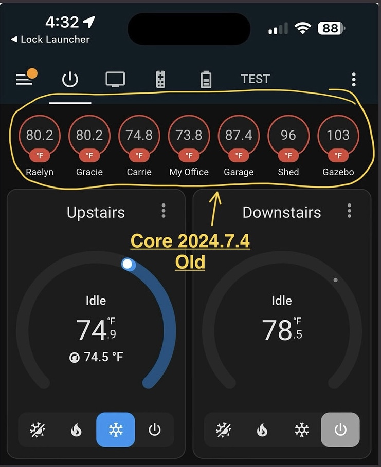

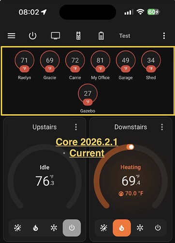

My badges don’t align properly after Core 2024.7.4 Please assist reducing wasted space between badges. I presume it’s a responsive layout issue where the spacing or sizing is causing the icons to not fit properly.

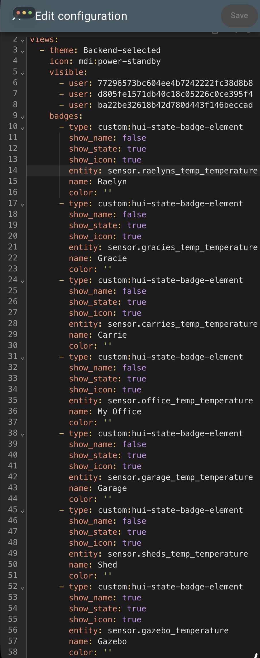

Below are pics of my Dashboard raw config yaml on my mobile device.
Thanks in advance
