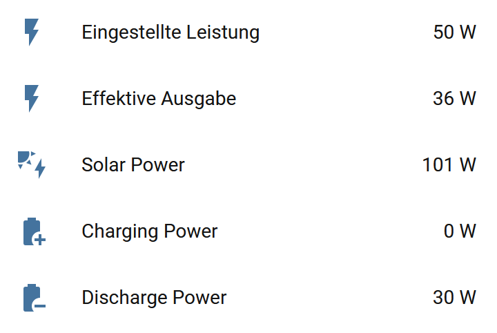

something about “efficiency”. 101 W solar + 30 W discharge Power is resulting in 36 W meassured at the powerCord with a Shelly.
There must be something wrong there, these numbers don’t add up at all.
Did you try to run your system with only one Noah first and see if the numbers make sense?

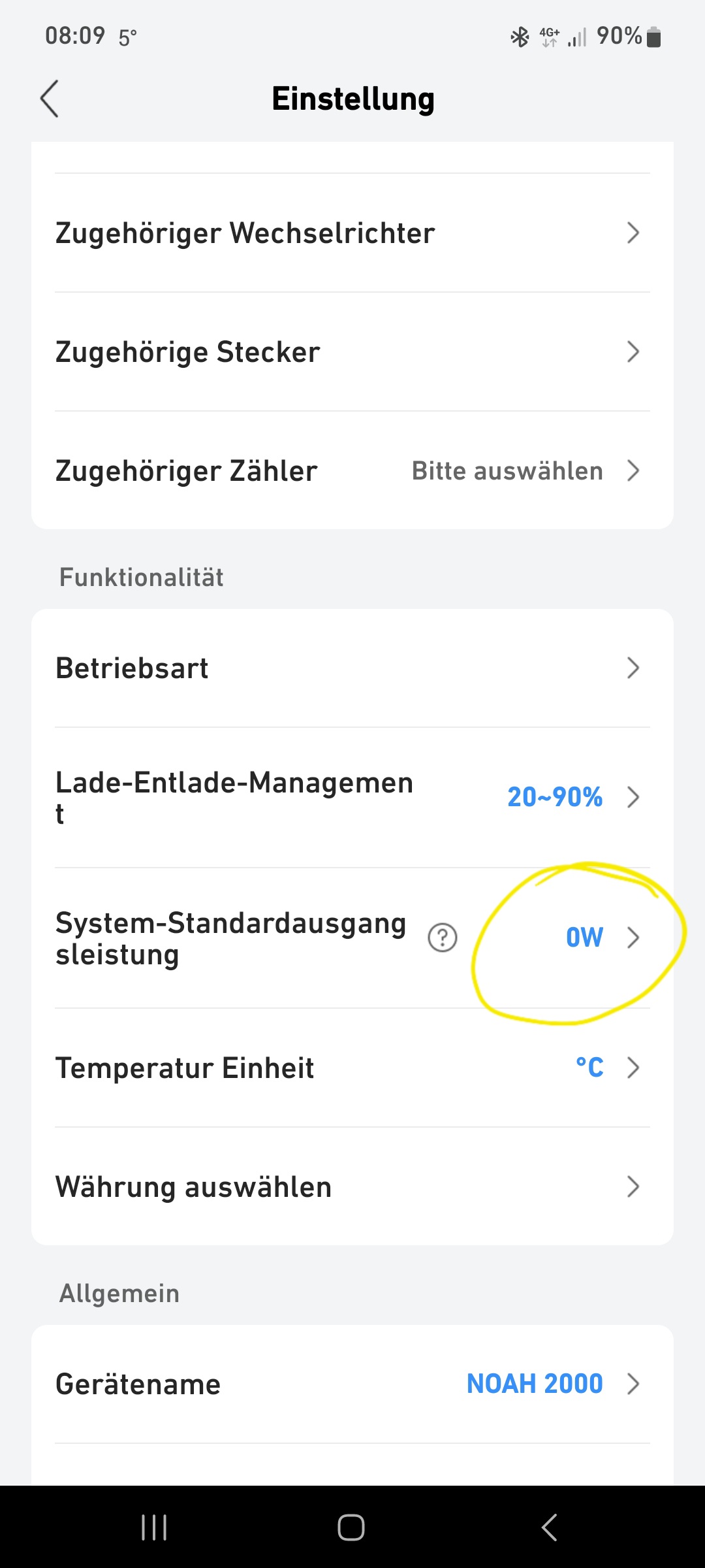

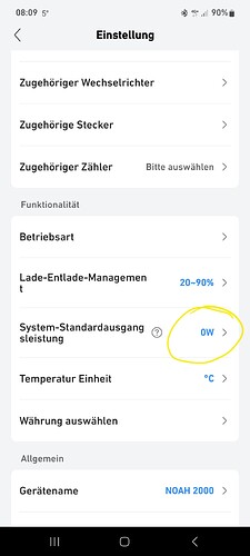

In my Shinephone I can set consumer first and 0 W output - screenshot in German attached. (Are you also located in a German-speaking country or does Solakon deliver abroad?)
In consumer first mode I use Noah-mqtt add-on to communicate with Noah, which works very well. (The Growatt integration didn’t work for me.) When you set 0 W output, you are basically running a battery first mode. Noah will always output the solar power once the batteries are fully charged.

And i did never see the mentioned optin. It was set to 150W and i changed to 0W.

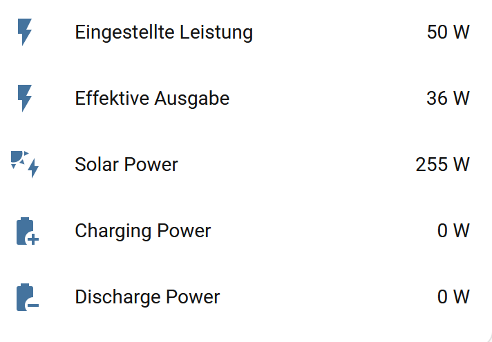

This is really crazy:
Hm, this really makes no sense. Any support from Solakon or Growatt so far?

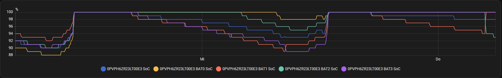

Well - guess this is documenting that there’s an issue in the SoC Management. The SoC was somehow blow 90% and than the batteries started to load. Until at about 12:00 (High Noon :wink: ) there’s a “jump” in the graph from 93% SoC to 100%. Also all 4 batteries are on 100% now. As there was no “solar bomb” that could have filled the batteries this can only be a bug or problem somewhere in the communication.
