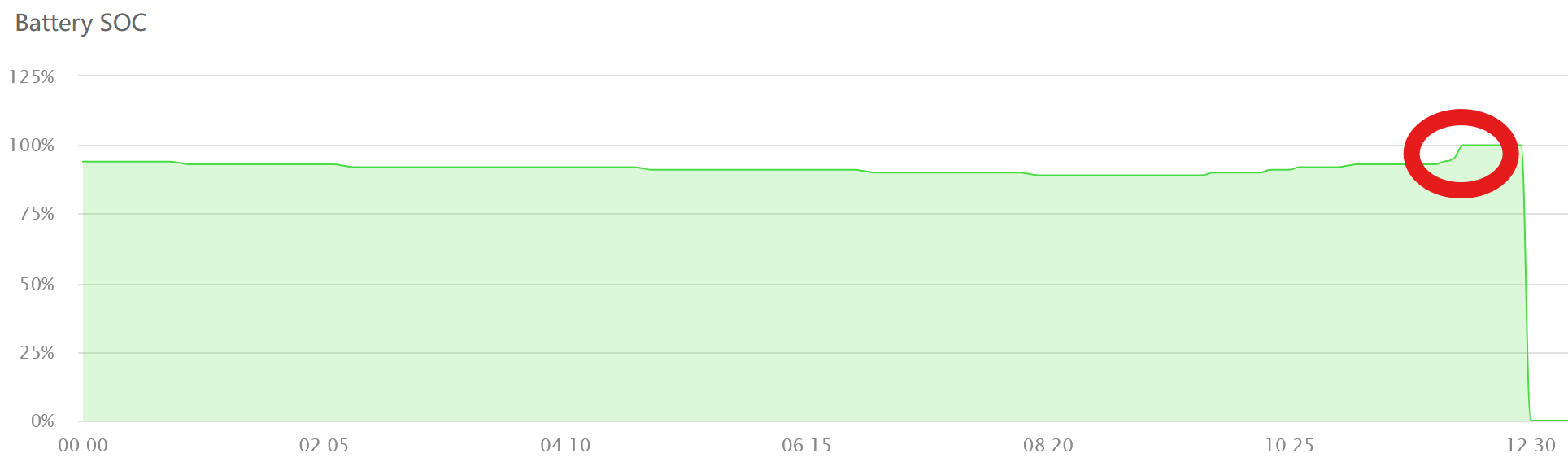

I also checked in the web interface and can see there the same issue.

What he found out is that the batteries seems to loose contact causing them to change the order in the staple. This can be reproduced in the data he provided.
Unfortunately a customer does not have direct access to the log files.
