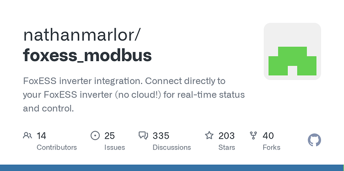

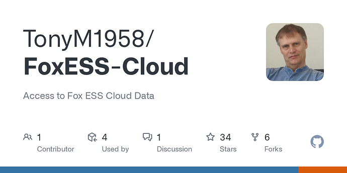

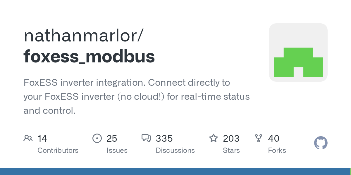

It can be integrated to home assistant via Modbus but i guess also a cloud integration, but i want to have everything local only.

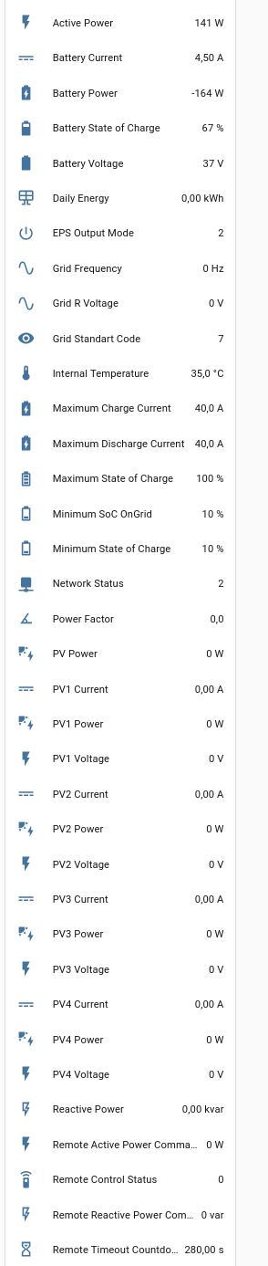

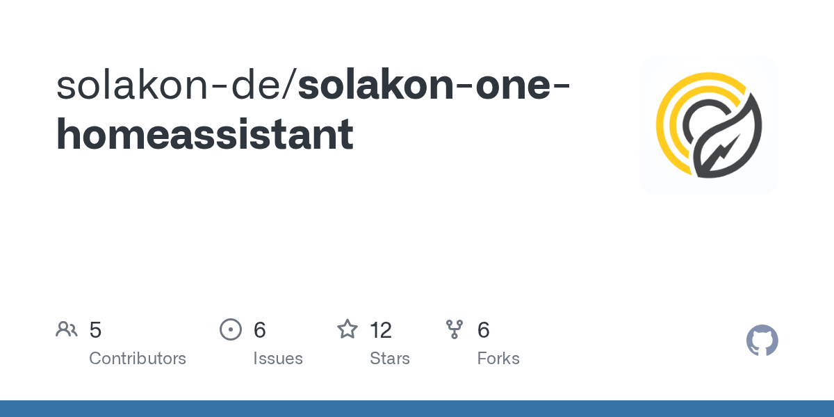

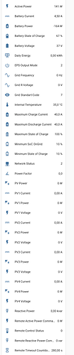

It works perfekt for my intention. I ordered an Modbus to TCP converter but i noticed that i don’t even need it for the Avocado Orbit. It exposes modbus via TCP/IP allready and used the Solakon ONE integration:
So this is how it looks for me now:
Works for my homelab Setup! I have an UPS that can power my Homelab for quite a bit before i have to take actions.
