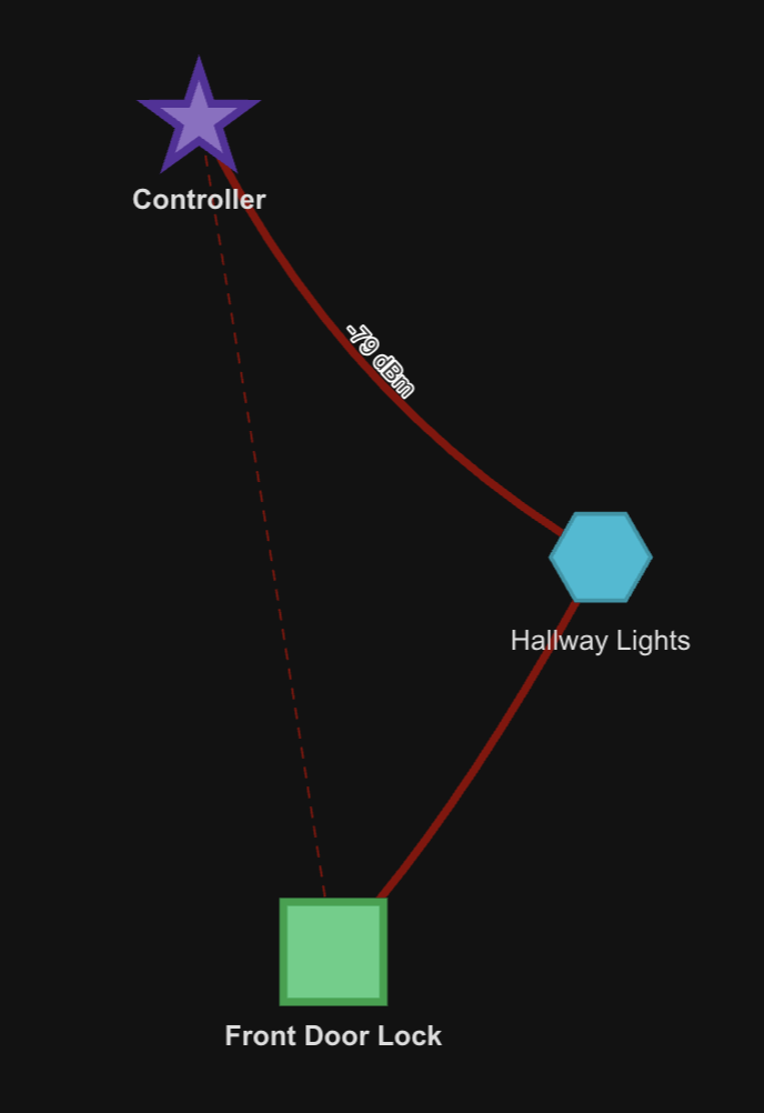

Is your lock node4?
Yourlock >> Device info >> 3dots next to configure
Look at stats and provide those details
Yes, node 004 as in the logs.
Here’s stats on the “Hallway Lights”:
And the nice graph:
Maybe try rebuild route on lock
What type of light is it connecting with? Is this bulb in recessed housing or enclosure made with metal?
Thanks for taking time to respond. To answer your question:
The “Hall Lights” is a Zooz wall switch, in a plastic wall box. Rebuilding doesn’t change the routing – those Hall Lights (switch) is line-of-sight to the door lock, and almost the same to the controller. A logical hop. Other z-wave devices use the Hall Lights as their hop.
Looking at stats of other devices the ratio of dropped RX to received is similar with other devices that seem to be working fine.
Note that the lock is battery operated, and I have no idea how old (or good) its z-wave radio and code is compared to newer devices. The round-trip-time seems very high, but is that due to slow, underpowered hardware in the lock or a network issue? Or maybe the device is just not reporing its new state and instead going back to sleep. All wild guess. I only have logs to give me a hint.
I’m very curious what the message in the zwave logs mean. Maybe due to the RTT being long the z-wave driver (or the ZST39 controller) is timing-out too early?

RTT is high but other than that all looks OK. I’m guessing it’s timing out while communicating since I think one of the log messages said “time out”. Did these problems just start?
What’s battery %?
Maybe replace battery :person_shrugging:
I considered the battery. It’s a 40%, but w/o any measurements (radio strength?) who knows what that means?
And w/o any changes (battery or otherwise) my RTT is now showing much better. Although I don’t know over what time period that RTT is averaging.
All so hard w/o a way to measure. I added counters to track how often the door is instructed to lock and how often HA does not show it locked after a timeout. But, sample size is so small (a few locks per day)… Learning a tool like Zniffer might be a wise investment in time.
Trying to understand the logs better is probably the best way forward – or changing the batteries and ignoring it…
Thanks,
With improved RTT did errors go away?
Some of my battery devices become weird under 40% battery.
