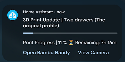

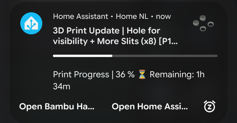

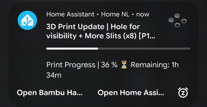

Example Notification
Example Progress

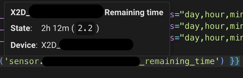

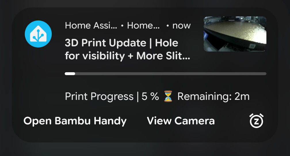

Works nicely, except for the "remaining" part - it shows "2m" in the notification, while in reality - it's "2h 15m". Please check the template.
I checked the sensor value - I believe it's in "hours" (it's coming from Bambu Lab integration)
I checked the source code of the integration - it should be set in minutes indeed, yet somehow my printer got it in hours. I manually changed it to minutes - now all's good.
