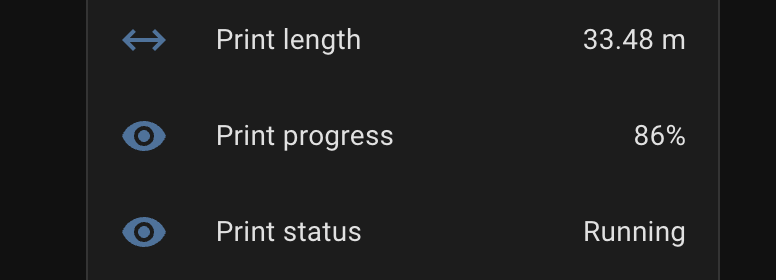

I think you can utilize sensor.bambu_lab_x1c_print_progress sensor )
Yes, that’s exactly the sensor I’d use. I just don’t have the knowledge to implement it. I’ll have to see about that first.

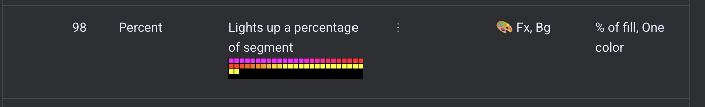

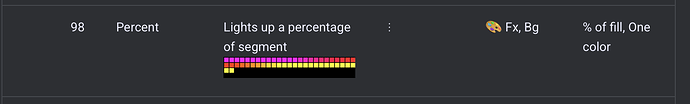

I think it could work be setting the print pre-set to the ‘percent’ effect within WLED. The parameter of that effect sets the percent of the fill (see below).
That number could be set as follows using the ‘print progress entity’ of the bambu printer integration:

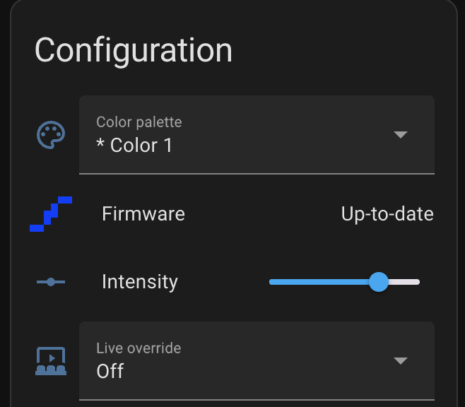

Which would set the WLED intensity value:
This code might work:
service: number.set_value
metadata: {}
  value: "{{ states('your_printer_progress_entity') | float(0) }}"
  entity_id: number.your_led_strip_intensity
The trigger would be whenever the print progress value changes.
