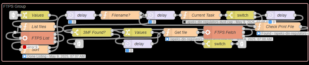

I have eventually got Postgres setup, but its not creating the table prints, there is an error showing in NodeRed, any ideas what could be wrong?

This did not initialize the tables, there should be an option in the nodered flow to force the initialization of the tables if it is all setup correctly. “Force Init” will force create all dependencies and try fitting in the current print if it failed. Though, if the DB flow is correctly setup, it should run through this initialization check each time a print goes through, unless the HA nodes configuration (server setup) is not working, which you can tell if there’s nothing going on below the blue nodes.
EDIT: All sorted with the help of chat gpt, up and running.
Hi, so for some reason using “node-red-contrib-postgrestor-next” palette would not connect to my database however i tried. I tried Postgress 15 and TimescaleDB addons. So i have used “node-red-contrib-postgresql”. However when i deleted "node-red-contrib-postgrestor-next"and reimported the flow it was still looking for “node-red-contrib-postgrestor-next” so i copied all the postgrestor nodes over to postgresql, now this creates the database and updates the energy side but all other fields there is a red warning triangle in grafana saying db query error: pq: syntax error at or near “PLA” on all 3 differnt dashboards. I named the data source in grafana 3D Prints - PG13 as stated, im getting close
