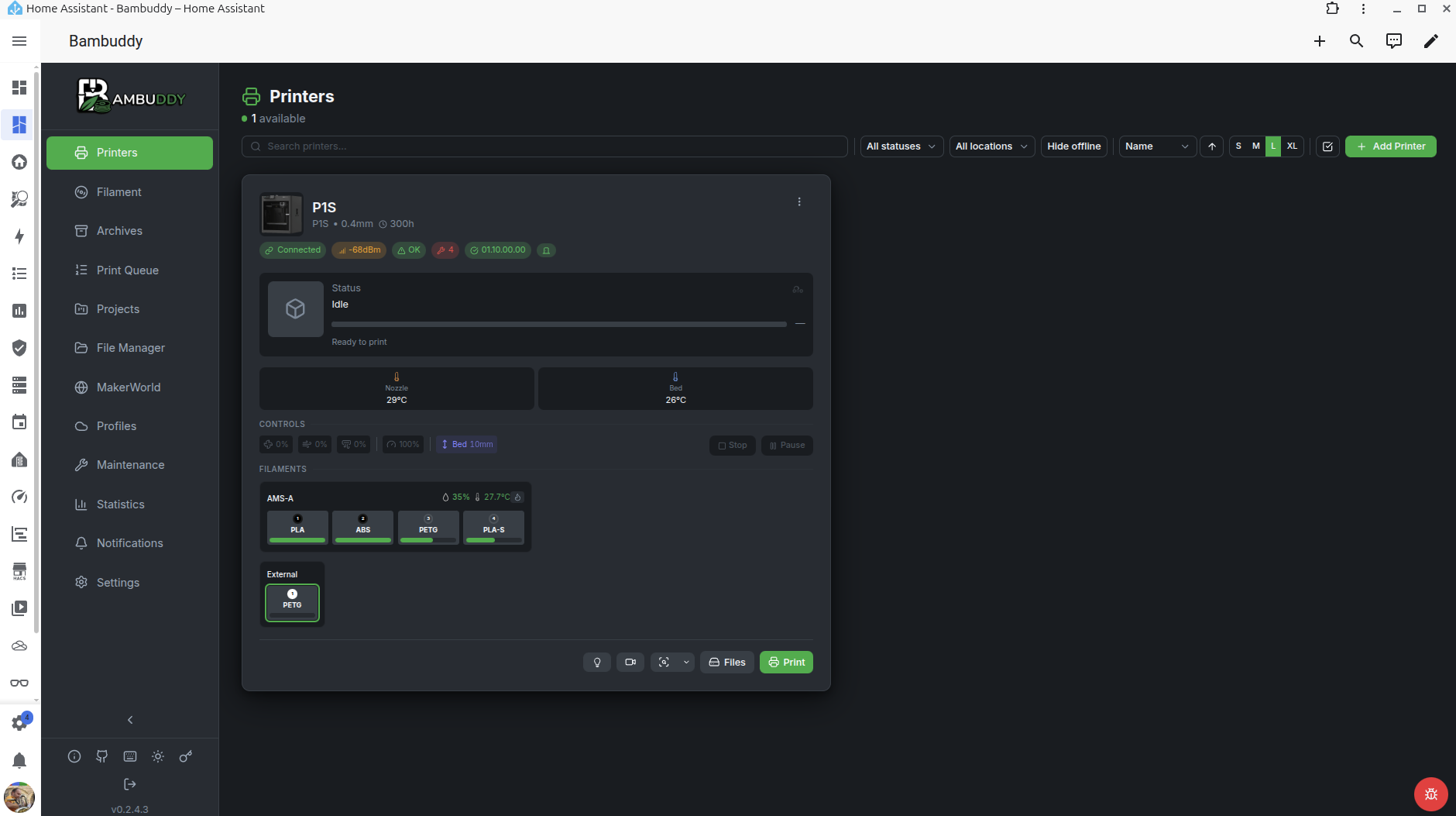

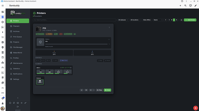

I've been running BamBuddy to manage my Bambu Lab P1S locally — no cloud, no Bambu account required. It's a great self-hosted alternative but until now there was no proper way to run it as a Home Assistant add-on.
So I built one. :tada:
What it does:
  • Wraps the official BamBuddy Docker image as a native HA Supervisor add-on
  • Persistent storage — your data survives updates
  • Configurable bind address (useful if you run Mosquitto on the same machine and have a port 8883 conflict)
  • Embeddable in the HA sidebar via a Webpage dashboard
Installation — one step:
Add this repository to your app store:
https://github.com/naked-head/homeassistant-addons
Then install BamBuddy from the store like any other app.
HTTPS + sidebar embedding:
If you access HA via HTTPS and use Cloudflare Tunnel, BamBuddy will be blocked from embedding in an iframe by default due to CSP headers. The README includes step-by-step instructions to fix this with a Cloudflare Transform Rule — it takes about 2 minutes.

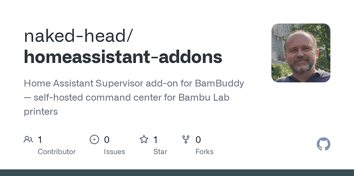

Repository:
Feedback and contributions welcome!
