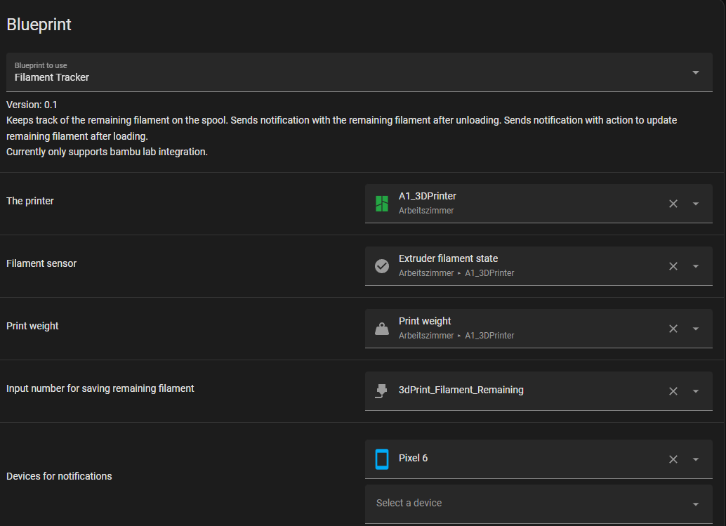

Here’s an example config:
I hope this is useful to someone.
