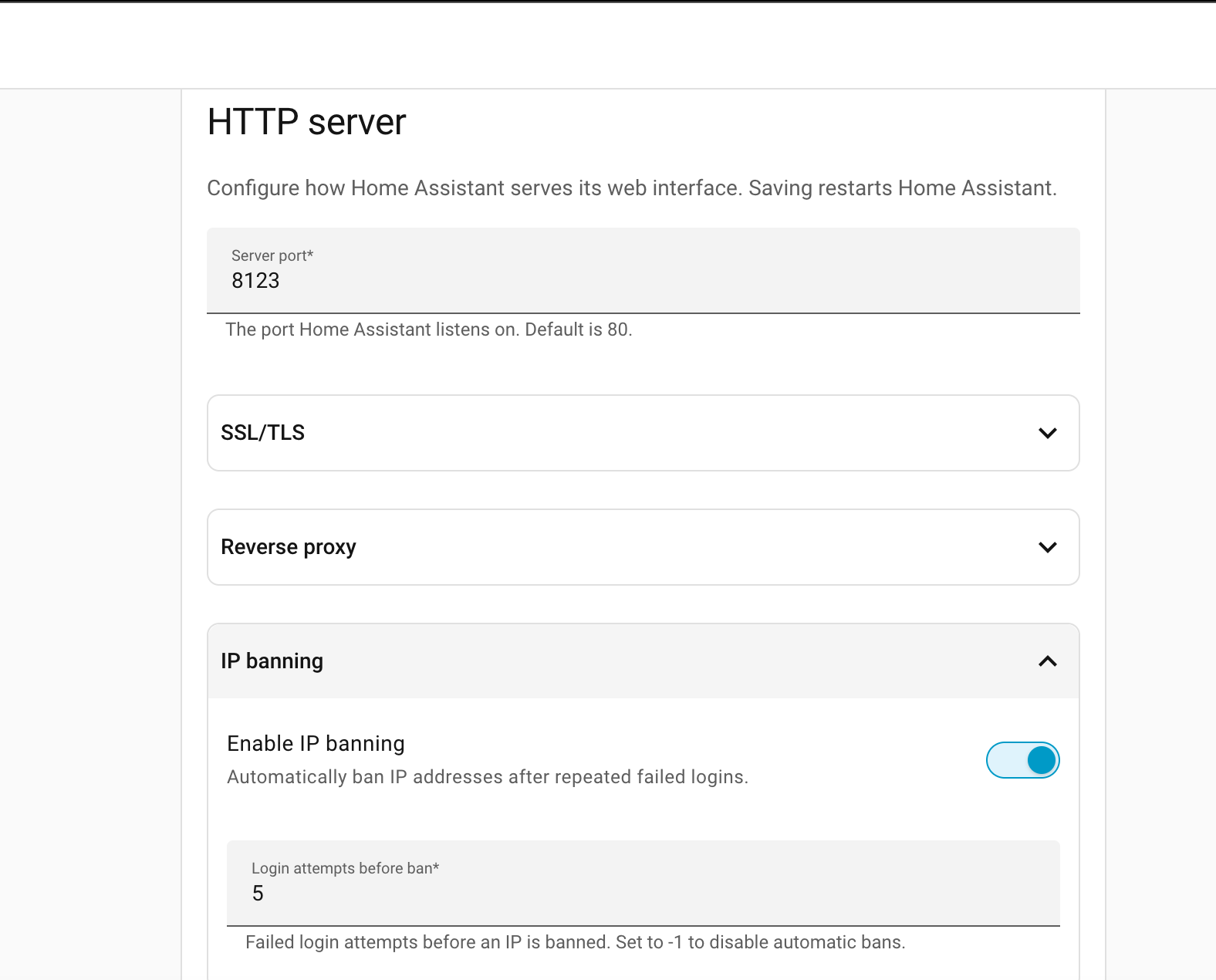

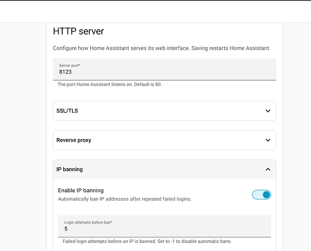

It’s moved out from configuration.yaml to Settings → System → Network → HTTP Server now, see pic below.
If you have anything http-related in your configuration yaml you should have gotten a warning that it is being deprecated. You can safely remove it from configuration.yaml, restart and it will appear under the settings. Since you have the threshold set at 5 attempts you will not get any entry in ip_bans.yaml until someone tries 5 times from the same IP.
