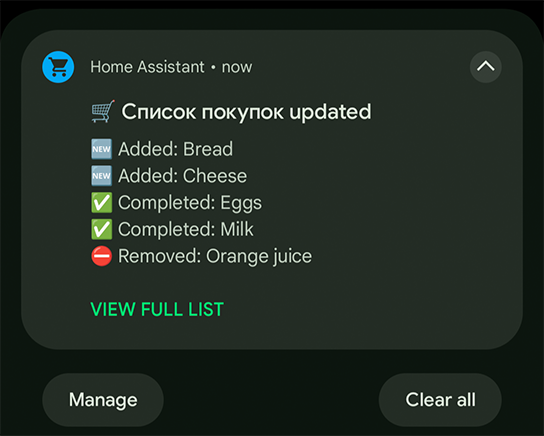

I want to share simple HA automation for shopping list notifications that buffers multiple item updates and sends a single combined notification instead of one notification per item. This is especially useful when adding items via Assist, which often send multiple rapid updates.
Key features:
  • Buffers all shopping list changes for 15 seconds, then sends one notification with all changes.
  • Tracks the following actions:
    • :new: Added
    • :white_check_mark: Completed
    • :recycle: Restored (unchecked)
    • :no_entry: Removed (only if not completed)
  • Capitalizes item names for better readability.
  • Includes a notification button “VIEW FULL LIST” that opens the shopping list in the HA app.
  • MDI notification_icon
  • Adds custom notification channel to set a specific sound or behavior on Android devices.
Important note:
Currently, the shopping_list_updated event does not support user IDs, so this notification cannot be filtered per user.

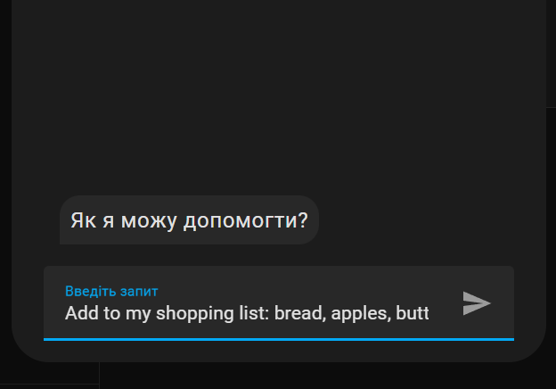

:arrows_counterclockwise: Update: Per-User Notification Workaround (Accurate for All Inputs)
I previously mentioned that per-user notifications aren’t possible because the shopping_list_updated event doesn’t include a user_id. While that’s still true, I’ve now added a helper automation that accurately tracks who made the last shopping list change, even for manual edits via the UI, Assist, or service calls.
:brain: How it works:
  • This automation listens for:
    • Google AI Assist conversations (e.g. when using voice)
    • All service calls to the todo domain: add_item, update_item, remove_item
  • It extracts the user_id from the trigger context
  • It then maps the user to a person and stores their name (id) in the input_text.todo_last_user helper
This allows my main notification automation to use that user ID to:
  • Send the notification to the right person (notify.mobile_app_{{ notify_user }}_phone)
  • Mention who updated the list (Updated {{ display_name }})
:brick: Requirements:
  • input_text.shopping_list_buffer – stores buffered updates
  • input_text.todo_last_user – holds the user ID (like name1 or name2)
  • automation.store_last_todo_list_user – helper automation that tracks who last edited the shopping list — whether by voice (Assist), service call, or UI
  • The user_map dictionary should reflect your user setup
